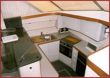

Two double staterooms are adequately sized, each with an equally good size head and shower with partial fiberglass liners. The layout is sensible, permitting ease of movement without clashing doors or silly bottlenecks. The designer obviously knew what he was doing. The large U-shaped galley is one of the more outstanding features. It has plenty of counter space, as well as storage cabinets, featuring a large double basin stainless sink and an under-counter Subzero reefer/freezer combination with 24 cubic feet of interior space. Although the galley is down, it is only separated from the salon by a counter divider which makes both galley and salon feel considerably bigger than they really are, not that either are actually small. Both are more than adequate.

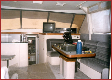

The salon has a forward L-shaped settee as most late model Bertrams and other convertibles do, with a fixed hi-lo table. The layout of this is great since the table does not take up the whole area of the settee so that 3 people can sit here with ease for just relaxing without feeling like you're in a movie theater. Very sensible. In addition to which there is room for two swivel chairs and the two little bar stools at the port side counter. We really don't find many boats this size where six people can come in and find a place to readily sit down and have a conversation, but this is one of the few.

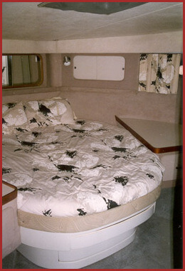

We also liked the layout of the master stateroom that has a large, irregular shaped, almost queen sized berth with large side tables, as well as a bit of floor space. The hanging lockers are a bit small, but at least there are two of them. Each head has a private stateroom entrance, and both heads are more than adequately sized. Very nice indeed.

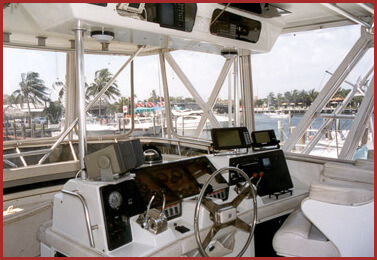

This model was fitted with the optional pipe frame hardtop with overhead electronics cabinet. Overall, the bridge is very well laid out and the ergonomics are great. No cramping or bottlenecks at all. Typical of all high quality boats, you find things like the bridge windscreen attached to a stainless tubular hand railing, both to make it good and solid, and also to make sure that people have something to hold onto other than a piece of Plexiglas. It's the little things like this that add up to make for a nice boat. Eliminate the unimportant stuff and make sure what is needed is there. PTL.
