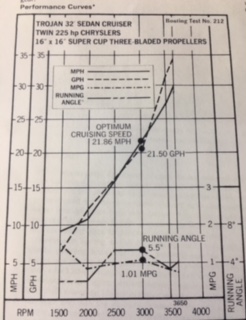

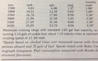

F-32 Performance Curves
F-32 Model 321 GPH, MPH, MPG

The performance numbers I posted seemed high to us but are very similar to the numbers Trojan states in 1974 and in 1976
The performance numbers were with a 2 to 1 trans and a 20 x 21 Bronze Prem prop.

AndyF32 wrote:Bob,
Do you have numbers for a 1990 F32 with 270 crusaders and 16x16 props?
Thanks
Andy the speed numbers would be the same as those are in the charts at the top as they are with the same 16x16 props . Fuel burn would be close also . Remeber these numbers are for a fresh out the box Trojan .

I didn't take a detailed look at these numbers until now... I see the notes under the summary table in the second picture talk about range in terms of statute miles, not nautical miles, so I am wondering if the speeds reported are in statute MPH and not knots? If the speeds shown ARE statute, my numbers are almost bang on at all RPMs after almost 40 years!

Yes you are correct MPH
Good to have conformation of this old data.

And someone posted the numbers were not possible on another thread "The coveted 20 knots cruise seems to be absolute top-end and only under absolute perfect condition"captainmaniac wrote:I didn't take a detailed look at these numbers until now... I see the notes under the summary table in the second picture talk about range in terms of statute miles, not nautical miles, so I am wondering if the speeds reported are in statute MPH and not knots? If the speeds shown ARE statute, my numbers are almost bang on at all RPMs after almost 40 years!
While I find them a little optimistic It is realistic to get close
FWIW My F36 with a total HP of 655 (vs 660 for the 440) tops out at 29+ knots (33.4 mph ) full fuel and water . My Boat is heavy due to My junk and lots of added gear , hard top etc
A friend with a F36 is getting a round 20 with 440s at 3000 stock props work on getting full rpm at this time (timing and carb issues and bottom could be better )
