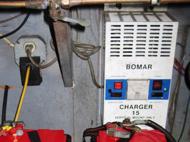

The previous owner replaced all three batteries with nice Rolls AGM batteries, but still had the old Bomar 15A charger that is not optimal for the AGM batteries. This was on my list of things to do, but not near the top. When I was getting ready to leave the boat on a Sunday evening, I noticed two problems. First of all, the battery charger was not charging at all. Secondly, the stuffing boxes were leaking a steady stream of water, not the drip or two a minute that I was expecting to see. Of course, I did not have the tools onboard to adjust the gland nuts. Needless to say, I did not go back home that night!
After going to Home Depot to buy a pipe wrench and a slip nut wrench, I correctly adjusted the packing to get the desired drip rate. Then, I got on the internet to research battery chargers.
The next morning, I headed to West Marine to see what they had for battery chargers. After some deliberation, I decided to go with a 30A charger that was well suited to AGM batteries, but not too expensive. Because I upgraded the charger amperage, I also needed to rewire all the connections, so had to buy wire and connectors among other things. I had to visit a few different stores to get all the parts that I needed.
One of the exceptions noted on my survey was the unprotected outlet in the engine room. I decided to remove this outlet, that was used to plug in the old battery charger, and direct wire the new charger instead.

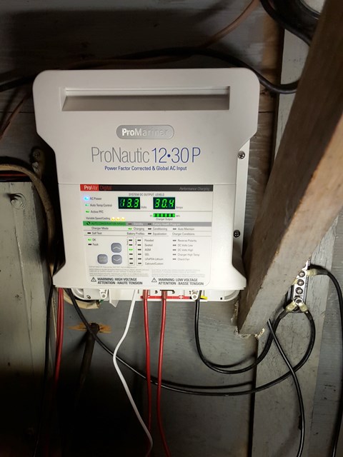

Five years later, I found a serious problem with my installation: ProNautic Battery Charger Install Problem.
Here is my old charger: And here is the new one during installation:

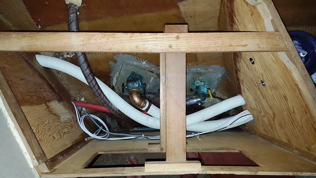

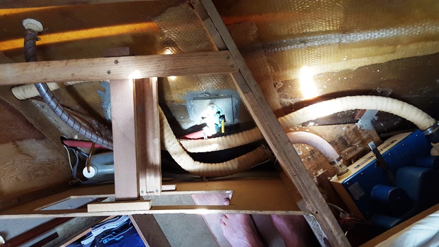

Our boat came to us with an old Raritan LectraSan MSD with no holding tank. The waste is treated by converting salt water to chlorinated water using an electrode in the LectraSan and discharged. The area we boat in is not salty enough for this to work correctly, so the previous owner installed a salt generating system.
I had a number of issues with the installation, in addition to the noxious smell we were encountering.
1) The wiring was insufficient for the current draw of the LectraSan. With a 50' path, Raritan recommends at least 1ga wire, but I think 1/0 is a better choice. The LectraSan requires 50A at 11V to operate correctly. The wire supplying the unit was clearly 10ga Romex solid core wire, just like you would find in a house! I was seeing about 10.5V at the unit when in operation, which explained why I was getting a low salt light on the panel.
2) The salt generator was basically a covered bucket with a toilet fill valve controlling the water level. You dumped in some solar salt and the system pulled some of the salt saturated water each time you flushed the toilet. I am quite uncomfortable with this system in a boat due to the chance of a valve failure or a broken bucket leading to lots of water in the bilge.
3) The hoses did not look like they were completely on the hose barbs where they entered the LectraSan, and there was a coupler in the hose from the head to the treatment unit that also did not look like the connections were solid.
4) The hoses were food grade nitrile, but not marked as sanitation hoses and I was not sure if that was responsible for the odor or if they were just old.

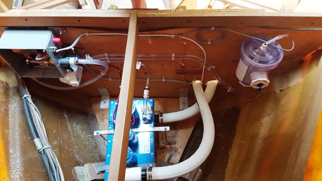

After talking to Raritan a couple of times, I came to the conclusion that to get this system working would cost me about $1,000 to upgrade the wiring, replace the hoses and electrode, and rebuild the treatment unit to get rid of some minor leaks. And we would still have a 20 year old system. We thought about different systems to meet our needs, including ones with a holding tank so that we can boat in no discharge zones. We decided to go with a type 1 MSD for now and not have the hassle of pump-outs. If we decide to cruise in NDZ's later, we will add a holding tank and Raritan's Hold N Treat controls.
The Purasan is a more complicated system that uses fresh water, pumps, manifolds and halogen tablets to generate a chlorine/bromine mixture that is injected into the treatment unit. This uses much less power (only 10A) than the current LectraScan units, but at the cost of a more complicated plumbing and electrical installation, as well as additional space for all the components. It works with fresh or sea water, so it is quite flexible on where you get the water for your toilet from. And it allowed me to remove the salt generator, which freed up storage space under our dinette seat.
Here is a photo of our old LectraSan installation: And a couple of the Purasan installation:

During the installation, some additional reasons for the noxious smell came to light. The hoses were not high quality sanitation hose, and whoever did the install cut the ends of the hose to help get it started on the hose barb. Unfortunately, this was a bad idea in the first place, and poorly executed to boot. The hoses were slit up to the point that fluids were leaking where the hose barb ended because the slit was as long as the barb and extended under the hose clamps.
I am happy to say that the new Purasan system is working fine and meets all our expectations! It is even easier to use than the previous system because one button flushes the head and activates the system at the same time.

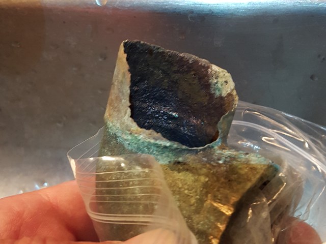

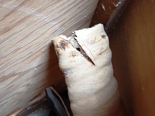

Also, when I removed the discharge hose from the through hull, I found this:
Needless to say, not only was this a source of leaking sewage that was not properly treated due to installation issues with the system, but was also a great way to sink a boat!!!I am happy to say that the new Purasan system is working fine and meets all our expectations! It is even easier to use than the previous system because one button flushes the head and activates the system at the same time.
