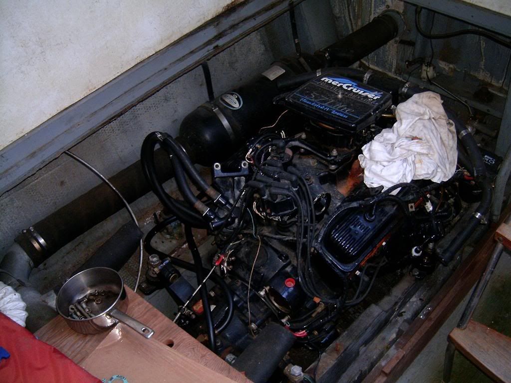

Your mention about the risers maybe too high for your bunks makes me wonder if you don't have the centre style riser. That is where the Manifold log has the riser above it. This is common with Crusader replacement engines. The original engines would have risers mounted on the end of the manifold logs which is lower.The 5.7 engines would not be origial. I looked at your photos but didn't see one of your engines.

http://i948.photobucket.com/albums/ad32 ... IM4345.jpg
jimbo, the engine pics are in the first group of pics, one of each and one of jenny
the 5.7s have just been added and not even started yet. One of the manifolds is cracked as it was left upside down for the winter outdoors, I am going to start trying to fit the manifolds today as the boat is at work now.
