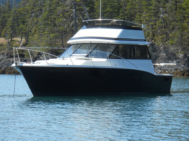

Hi Guys,
Long time, no talk to. I hope everyone has been well.
I'm finally gonna repower this winter, and am considering used diesels vs. new gas.
Does anyone know off hand what diesels have been installed in F32's, and with what results?
Thanks,
Dave Lofland

Just pulled the trigger and ordered a pair of new Yanmar 6by3-260's with ZF 1.51:1 gears. All electronic controls. N2K output.
