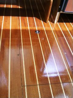

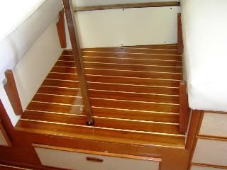

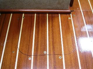

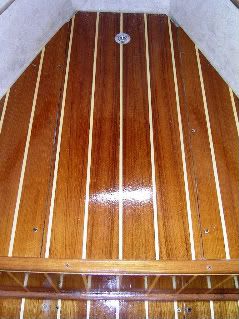

As promised more detailed pictures of F32 floor.
Image Image
Image Image
Hope these will better show what I did. I hope to have in the water in the next few weeks, Just finished new spray rails on my F30 sport fisherman, I think they built the boat interior after they attached the rails.

Dan Faith:
In your pictures, the top right hand picture, is that the corner of the fridge and steps leading aft? I see there is a hatch in the picture. There is a teak/holly floor in my boat but no hatch in that location. I'm third owner and the floor was in the boat when I bought it 2 years ago. Am wondering, should I have a hatch or does it vary year to year?

TC, Yes that is the stairs and the corner of the fridge. The hatch was not there but when I put new stingers in the bow I also put in a place to get into the hollow keel, I use this hatch to pump out the keel and keep it dry, it eliminates odors and the bilge pumps never run, I have found most of the water fills up the keel first, if water is to were you can see it the keel is full and it holds about 10 gallons. I have put a splitter in my shower pump and now just turn of the pump and pump out the Keel.
Cost of the teak and holy 1/2" plywood was $6.50 sq ft but we are not talking that many square feet for this area.

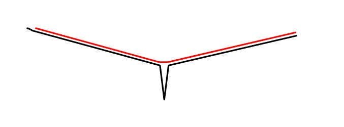

Hopefully I did this right and size isn't a problem...
Very basic and crude depiction, and others can elaborate if they wish to, but in general this is what is being talked about. When you look at the hull from the outside, you see the black line - the hull shape and keel. If you look from the inside, you see the bilge as shown by the red line. BUT the red line (glassing across the bilge) is really just a liner that hides the fact that there is a big open space beneath - the keel is not solid, there actually is an open space between its sides.
Most boats have at least one hole or opening in the 'inner liner' that lets gobs of bilge water settle down there as well - which your bilge pump can't do a darn thing about. On my boat, I have to pull up the carpeting and floorboards in the lower cabin area to find these openings - everything from the engine compartment bulkhead back is solidly glassed over.

Captain M,
I learn something new every day, even after years of reading about Trojans. I've seen references to the hollow keel before, but I guess I haven't paid attention.
Your sketch and explanation are very clear. Our bilge is completely glassed over as far as I know. From the forward engine bulkhead back, access is almost impossible what with the battery boxes, generator, and water tank.
In the lower cabin area, the floorboards are easily removed, and we clean that area about once a year. We've never discovered any openings in the liner in that area. Are you saying that it was designed with holes in it? I wouldn't be surprised if ours has been changed.
So what are the approaches to dealing with this situation?
