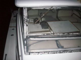

Guys and Gals,
I need some recommendations on painting my window frames and what kind of chaulk should I use?
I here is a link to some pictures. You can see a piece of chaulk looking stuff I am talking about.
I just finished replacing the front windows in the cabin and I painted the frames with Rust-o-Luem Black paint but was not really impress with the out come.
I am thinking that a paint that I can brush on will work better the trying to tape/cover so much area.
Thanks

After I painted the front cabin window frames and put the new windows back in a noticed it did not take much to nick the paint. The paint job looked pretty good and it may have been my brother couldn't seem to keep any tools in his hands with lettting them drop.
I thought maybe a different type of paint or method would make the paint a little tougher.

I attempted to use Alwgrip prime (chrome zinc stuff), after sanding and etching. I had a smooth surface. I then started to prime. Everyplace paint was still on the frame it popped. I resanded (everything feels smooth) tried again. The same thing happens. If I tried to sand all the paint off I will be there working for ages. :cry:
I resanded and went with Rustoluem primer made for alum to see if that would work better. It works better but still getting the paint to pop in some places.
If you have any suggestions I would love to hear them. I will be out by the boat pulling my hair out trying to figure out what to do.

Lots and lots of sanding and then going back and cleaning the frames. It is not perfect but it will last several seasons.
