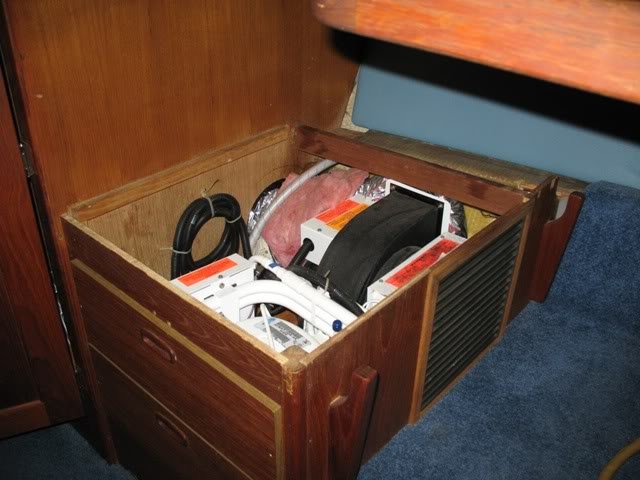

OK.... Here are the AC installation pics I promised. Let me know if you have any questions and I will do my best to answer them (installation was done by a prior owner). Pics are as follows :

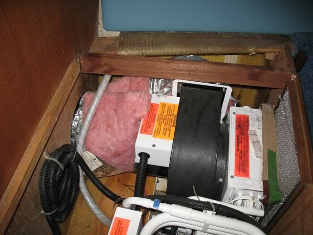

1 - AC (Cruisair StowAway 12,000 BTU model) is installed under forward dinette seat. Thru-hull and water pump to feed it (and strainer) are back in the engine compartment and hose is run forward. Drawers have been removed, and drawer fronts are just screwed in place so everything looks 'normal' when the seat is in place. The white hose you see (with blue stripe) attaches to a thru-hull about 12" above the waterline for the water outlet. Oh yeah - it is also on its own 15A breaker. In A/C mode I am normally okay, but if I try to use 'heat' mode I often trip the breaker.

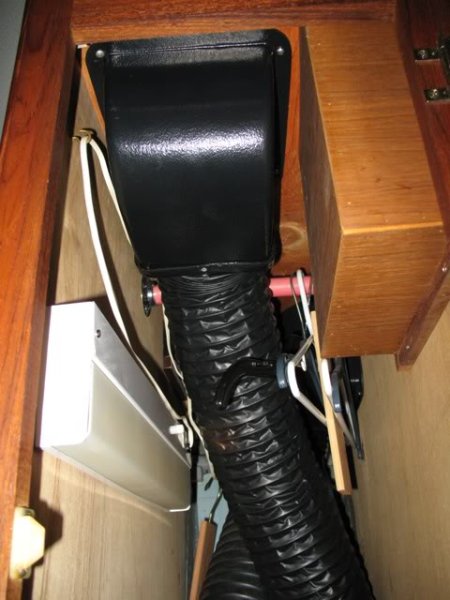

3 - Here you see the output of the AC (wrapped in pink insulation) ducted forward through the bulkhead, into the hanging locker.

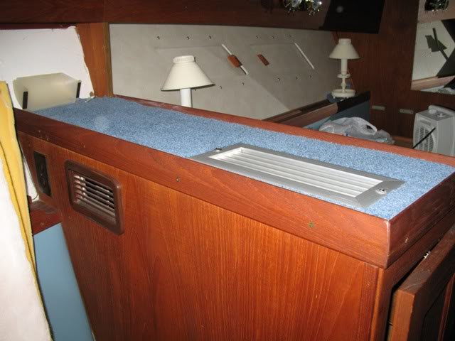

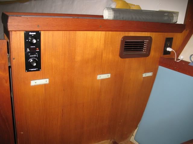

4 - Up above on this bulkhead, aft side, are the controls and a vent. The vent is ducted, and blows air aft into the Dinette area.

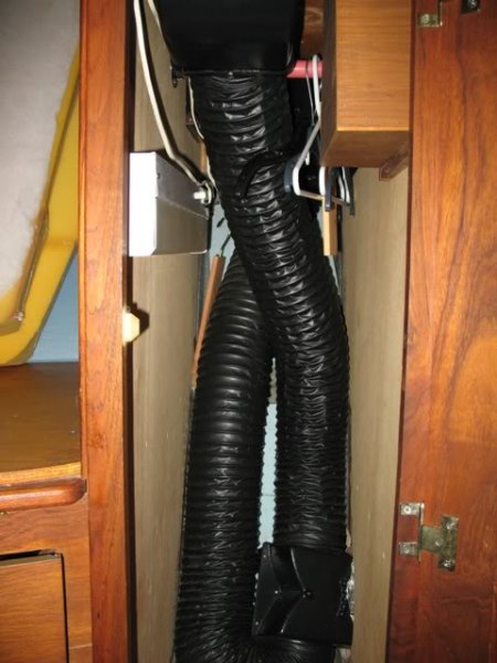

5 - Forward side of the hanging locker, you see two more vents - one on the top of the shelf (ducted, blowing air up and aft), and one hear the hull side (not ducted - letting 'ambient' cold air out of the hanging locker and helping vent it, forward to the v-berth).

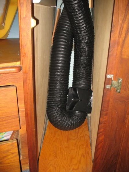

6 - Ducting in the hanging locker ... you can see the 'T' near the floor. This is what the duct wrapped in the pink insulation in the AC pic flows into. Two hoses off of this box both run upwards. Can't really see it very well, but there is a sheet of 1.5" styrofoam insulation between the hoses and hull side. Even with that, when I have the A/C running you can see a clear rectangle of condensation on the outside of the hull exactly where the hanging locker is.... so its cold enough in there to radiate outside... These hoses really annoy me - we basically lose half the space in the hanging locker because of them.

This works great for the lower cabin area, but my biggest regrets with this installation are the loss of storage space, and that it doesn't work too well for the upper salon area. In the heat of summer, and with all the windows on the F32, on a really nice sunny 90+ degree (with humidity) day We can get the lower cabin down to 68-70 degrees but the salon still hovers 80+. I have tried to find a nice way to run a duct to the salon area but haven't had any workable ideas yet (seeing how much condensation I get outside the hull when it runs, don't really want to run a duct near my electrical panel for fear of corrosion issues; other paths won't work with anything more than a 2" duct, which I don't think is big enough).
I have thought of relocating the A/C, but it is not ignition protected, and this really limits where I could move it.
