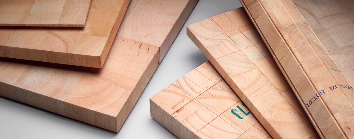

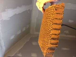

Re: Soft flybridgd floor
Photos of Tricel
- 00A674AE-49EF-466E-A97F-52B3D4778790.jpeg (33.69 KiB) Viewed 11338 times
- 9B7CD855-C597-4633-8658-B1A8B6D17573.jpeg (58.58 KiB) Viewed 11338 times
Bob, how do you avoid the resin flowing down into the core? It seems like it would fill up and get very heavy.
We would use a micro filler to make the resin into a glue or paste.
You Do Not want to fill the Tricel with resin.
Then we would glue the Tricel to the bottom sheet of fiberglass and the top sheet of fiberglass.
This is very basic instructions. Please feel free to call us

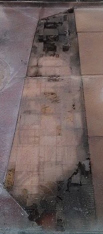

And a picture of wet balsa core.
Note: The black in this picture is balsa core that has begun to rot. The black balsa will turn to mud in it final stage of rot.
The lighter shades of black are wet balsa which will in time turn to black mud.
- 100B15BE-20AA-47DD-9284-C3E8F7AE0A6E.jpeg (35.27 KiB) Viewed 11184 times
