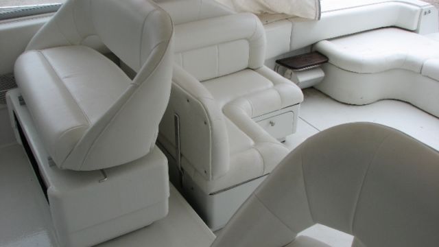

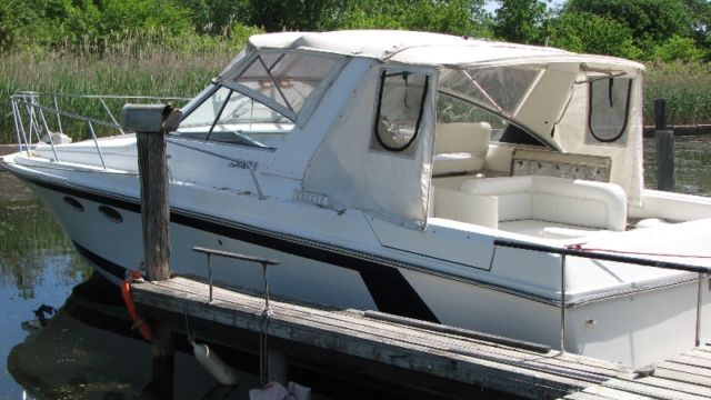

I just bought an 87 10 meter with a pair of 454s. Its a very nice vessel overall but has seen very little maintenance this season. I sea trialed her yesterday and was having classic fuel starvation problems. Fuel bowls were clean, no water with fresh fuel filters installed. She ran great at hull speed but could not jump up on plane without stalling. I highly suspect the anti-siphon valves are plugged or and that will be my first check when I get the boat shipped to home later this week. I had a limited time at the boat to go over it but I am confident that she just needs a thorough systems check and repair. It had a recent survey that was very complimentary that was performed by a notoriously thorough surveyor. The owner is not well and the boat has sat it the water unused this season.
I would like to know how access the fuel tanks better than trying to climb down in the engine room through the center hatch. I did find some portholes to access the fuel tank sending gauges but did not notice if there were hatches back there or additional portholes for the fuel pickup lines/anti siphon valves. I have a knuckleboom crane so I can lift the entire rear cockpit floor out, if it is designed to do so, however I can not find this info on here, so far.

Looks like you have a 10m "Mid Cabin" from your pics. That is what I have and the layout is completely different than the similar looking Express model of the same size.
For the tank access, specifically the anti-siphon valves, you need to remove the outer engine hatches. Move the corner bench I see in your pic and (wetbar, add'l bench) on the port side. The anti-siphon valves are right where the fuel lines connect to the tank. You have to sort of lay across the engine to remove it but an easy job and great place to start and work your way back towards the engine for the issue you describe. This was exactly my issue when I first purchased my boat.

From what I see, she looks like a nice vessel! We have friends with a Prestancia 30 and I'm certain you will enjoy the beamy 10 meter compared to the Doral. BobCT knows his mid-cabins! Those outer engine hatches provide great access. The biggest pain is getting the wet bar out of the way (if you have one). If you reach in the storage compartment of the seat and under the wetbar, there should be some bolts that you can unscrew in order to move them.
While you are inspecting the fuel system, look at the main fuel filters which should be mounted on the rear of the engines if they are factory. You can also check the in-line carb filter. I had some "gunk" in one of my anti siphon valves that managed to sneak through my fuel filter and clog up quadrajet carb filters as well.
