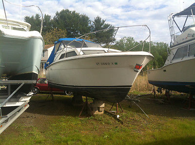

Well i put her back in the water around noon yesterday floated her for 3 hours then started moving up the river after about 10 minutes under way when things were nice and warmed up that's when I gave throttle and found this out and since I'm a chicken I only tried it once and for less than 10 seconds backed off and no more noise at all so just went 1 hour up the river to the marina at about 6 knots. I'll look for collapsing mounts and find a tutorial on shaft alignment and report back later today I will keep checking this thread though in case there are other ideas. The picture is how she sat for all those years until I got her.
