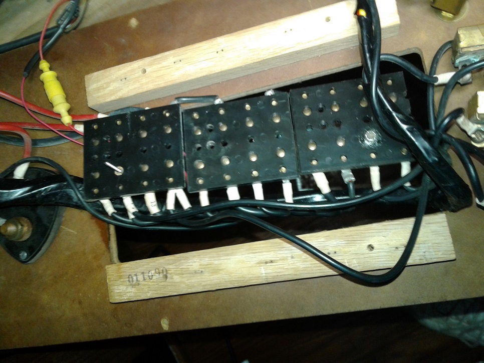

Looking for the 411 on fuse panel replacement. I am the new owner of a 79' F28 and have discovered that most of the electrical gremlins are in the fuse panel. The fuse terminals where the fuse is held and the point where the wire is attached is a two piece design riveted together and over 38 years these two pieces have lost contact. I noticed at least three of mine were hot at both ends of the fuse but dead at the wire going to the switch. Then I noticed an apparent previous owners repair where he drilled thru the rivet and used a screw to tighten the connection at three other locations.

the old tube fuse bar eh. Yeah they suck especially for high current draw such as bilge blower(s). Not sure about rivet getting loose but they will heat up and become less conductive and heat more till fuse gives. All can rewired to a blue water fuse panel with the newer type fuses but will be a pain. I have a whole panel for the f28 from a parts boat. You will fine that when you pull the whole panel the backside looks screwed together and is but glues also, it is a pain.
Just for the fun of it in the high voltage locker I have a master breaker box and a sub box using Siemen Breakers this gave me plenty of extra circuits to use for 120 V. Sorry I digress this is not the 12v fuses. I put bluewater controls and fuse for controlling the bilge pumps. Alas the bilge blower fuses must be watched.
Good luck with it I just emery off the old fuse clamps and squeeze them together ergo they make better contact.
F28 Fuse Panel.jpg (222.92 KiB) Viewed 5630 times
If I attached it right you can see the back of my fuse panel. In one circuit you can see one of the previous repairs, it is a very small nut and bolt sticking thru the back side. If the nut is loose both sides of the fuse are hot but the wire is not, tighten the nut and she works again. There are a couple other circuits done this way with different types of screws. I wonder if some work with the emory cloth as you mentioned and a drop of solder between the two pieces of the terminal would ensure a better connection. Maybe better than drilling and screwing all 12 terminals.
I have something like this in mind, if I run out of other projects.
Thanks for your reply!

I would move fuse panel replacement to the top of your list.
Lance F28
Posts: 46
Re: BREAKER!!!BREAKER!!!
Post by Lance F28 »
It has P-Dogg, I hate electrical problems and I think this will solve a bunch of them in one whack.
