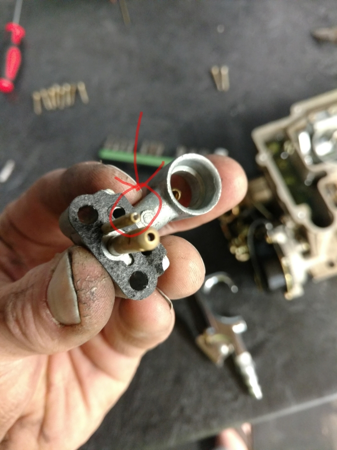

On an edelbrock or Carter the idle circuit is in the primary Venturi, this will cause alot of weird idle problems, zoom in on the circle
