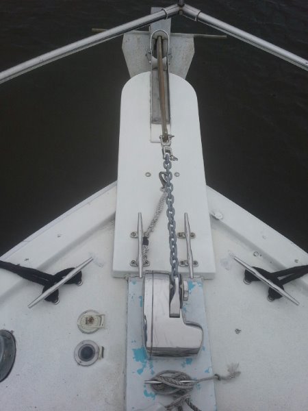

This is my set up I had a good before with the Good roller set up and it worked well put I wanted a Pulpit just because . I replace the good with a Lemar only so I could use chain . I would have gone with a Good rope chain but the Lemar was a Deal .

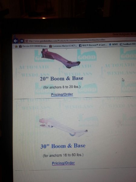

That what I used to have , Photo so the OP know what we are talking about

prowlersfish wrote: Sun Mar 03, 2019 5:55 pm This is my set up I had a good before with the Good roller set up and it worked well put I wanted a Pulpit just because . I replace the good with a Lemar only so I could use chain . I would have gone with a Good rope chain but the Lemar was a Deal .
Looks like you got a good deal on cleats as well -- I count five of them. :mrgreen:

Yup thats it, to add it keeps the boat length ( loa) the same as well. Thanks for posting the pic Paul.They really were good people with me.

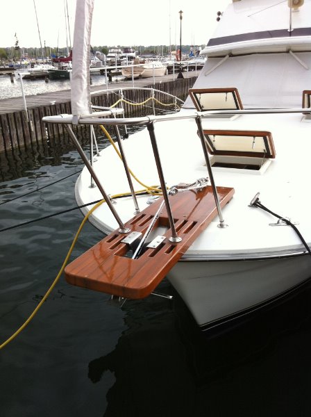

I'm a fan of teak -- out of respect to the history of boats and boat building, I just think there has to be at least some wood and brightwork. Call me an old boat fuddy-duddy. Not a Tri-Cab, but this pulpit was already on my F32 when I bought it. Finished with a few coats of Cetol Light followed by a few coats of Cetol Gloss.
