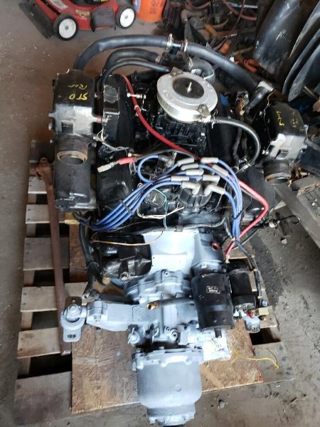

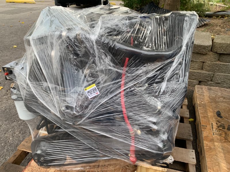

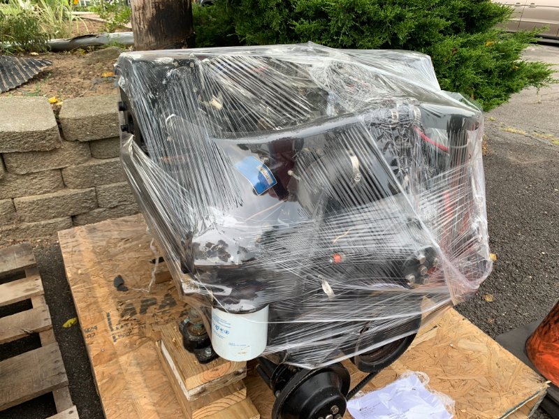

Ok been a while since I posted or updated. It's been a terrible running season. Long and short of it is 2 new engines.
If anyone needs any parts from ford 351 Merc 233 engines let me know. 2 rebuilt carburetors, air intakes, fuel pumps, starters, etc. Anything I can salvage off of the engines I will for you.

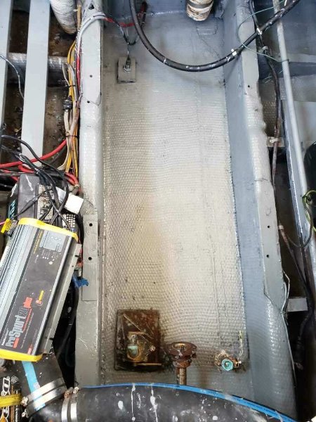

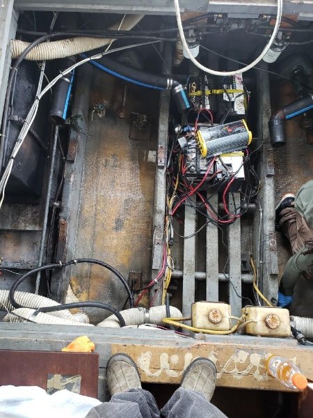

Old engines are out. And bilges are cleaned.
