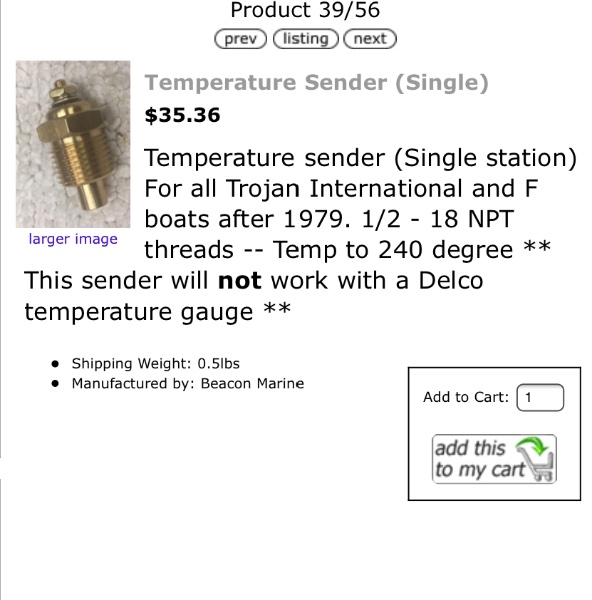

what temperature sensors should i get for block to send electric signal up to new gauges? i know senders should match gauges

Look up your gauges p/n and it should list the proper sender . The paper work with the gauges should also list the sender range .
They list the temp senders on your Amazon link also

Re: Stewart Warner Guages
Trojan always used 1/2 NPT best to check the size which you can not do with a ruler. take it to a hardware store and check size with female fitting.
