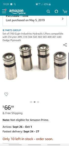

Have you got the part number for the lifters handy ?

HL-2011S
Screenshot_20190920-190954_Amazon Shopping.jpg (28.4 KiB) Viewed 11024 times
Re: 318 no oil pressure
No clue on the quality or fit of the lifters Sealed powers part # is HT 2011 $4.29 at Avance $9.00 amazon . Mike said something about possible over size needed ? I am not mopar guy so not sure .
So something I have not brought up . Why did you feel the need to put the lifters and hollow push rods in to improve oil flow ? was there a issue before ?
How bad did it over heat ? coolant or water in the oil ? Is it possible the bearings got wiped out ? How long has it been run with out pressure ?
