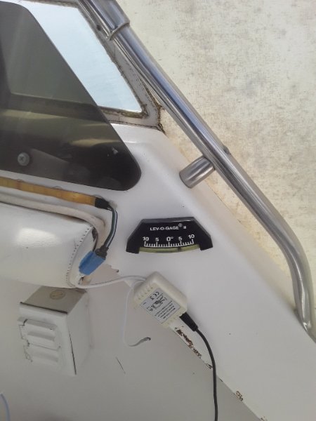

Pretty close to 4 deg. @ 20 knots no tabs.
trojan level.jpeg (36.51 KiB) Viewed 8017 times
