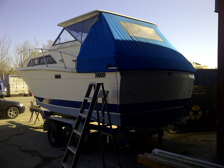

Winter house came off today and good clean up as well .. Tommorow antifoulin paint on bottom
Bimini top on
Bimini top on
