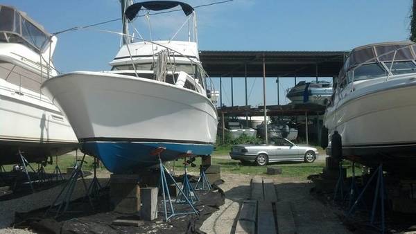

Looking to find some reasonable information. 1972 F31 flybridge with twin 233hp ford 351 mercruisers. Cannot seem to get 4000 RPM, only getting 3000. Where it stands now, I'm assuming improper screws. I currently have 14x14 installed.
What I have done:
- cleaned/scraped bottom free of growth
- timing set to 10*
- both two barrel carbs cleaned/rebuild
- new coils (internal resistor) no external ballast (non point distributer)
- fresh clean fuel supplied to engines
- Tach setup for 8 cyl
I'm topping out at 27 MPH at 3000 RPM (port) 2800 RPM (Stbd), cruising 15-17 MPH at 2400 RPM. Won't spin up past that. I currently don't know my fuel consumption at that speed. IMO not concerned since I'm not reaching higher RPM.
Reading from here and there, I'm getting top speed, just not top RPM.
Can anyone chip in their two cents on this?
- too much prop?
- too much timing?
- not enough fuel being supplied?
- etc...?
Who out there has the F31 with Ford Merc and what is their setup?

- image.jpg (51.66 KiB) Viewed 4835 times

Your speed is not to bad , but your rpm is to low . Do you have a reduction gear or a 1 to 1 ? If its a 1 to 1 then you have to much prop for sure .
Are you a Dandy Haven ? It looks like it in the photo , I may know your boat .
Re: 1972 F31 PROP/RPM/SPEED
I am at Dandy Haven. And correction to prop size. They are 16x16. And reductions are 1.52:1. Guessing the boat ran aground since the port strut is bent. After looking back at pics, I had one with the stamp of 16x16. These cannot be the original props for this boat. Let alone the correct size.
