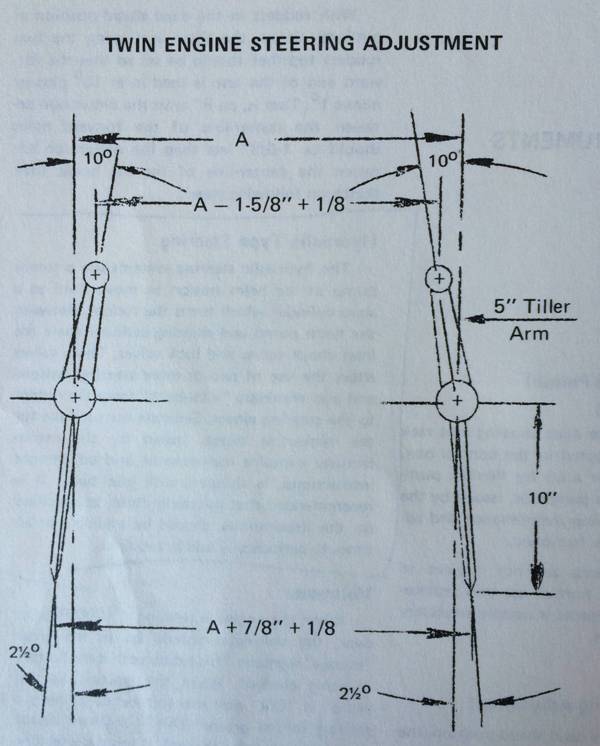

If you need to get to 3000 RPM to do 13kn you have a tach calibration problem, prop problem, bottom fouling problem, major trim issue, or your rudders are toed out way too far.... (or your trannys are slipping big time). Can't recall if you said this speed was measured by GPS, or by on board tach... if on board tach, it may need service.

or your rudders are toed out way too far - Actually has a slight tow-in.

Rudders are definitely one thing to look at then. They are each supposed to be 2.5°toed out. Good luck finding whatever else is going on.
