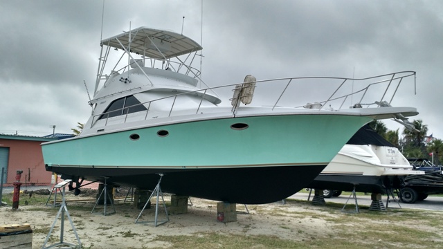

Got the bottom paint done, finally. 8 hours sanding and 3 coats on most areas.
I like the look of the black a lot better than the blue that was there. I think the black makes the boat look a little newer, if that’s possible.
I got 7 quarts of interlux for a deal on Kijiji, it had settled quite a bit and required about 10 minutes of stirring to get it all mixed, there is a lot of solids in that stuff. I added just a couple drops of thinner to help it roll out. That stuff sure covers well.
Holy cow sanding, 10 minutes in, I wished I had a much smaller boat. By time I had it all sanded I couldn’t lift my arms or do a sit up. I was using a 6” electric random orbit with 80grit paper which knocked ofF the lose paint very fast.
Of course a full face respirator is a must have, just shaking the dust off my coveralls without it had me gasping for air, the copper in the anti fouling I assume.
Here’s some pics

Looking good!
When I sanded my bottom, I started with a sander that caught the dust in a bag and quickly realized that I was making a big mess. I bought a Bosch sander with dust collection (https://www.amazon.com/dp/B0000VUN7Y/re ... sch+sander). What a difference it made with a vacuum connected for dust collection! There was virtually no dust escaping except when sanding the edges of the chines. The only downside was the mess it made inside the vacuum, and I certainly had to wear a respirator when cleaning out the vacuum.

When I did mine I wasn't wearing a full respirator - just a simple mask. Ended up blowing blue snot for about a week.
Re: Project "Tri Fly"
I really think the black bottom looks good. I changed mine from "matching paint" to black last time as well.
For the look I went with black too. Well, thats what Delta yachts ("the" delta) recommended, as they have been guiding the restoration, so I didn't protest, although you lose the ability to dive and see fouling, damage, etc etc if your boat stays in the water all the time like mine. So I also think like delta did that you are adding more value
