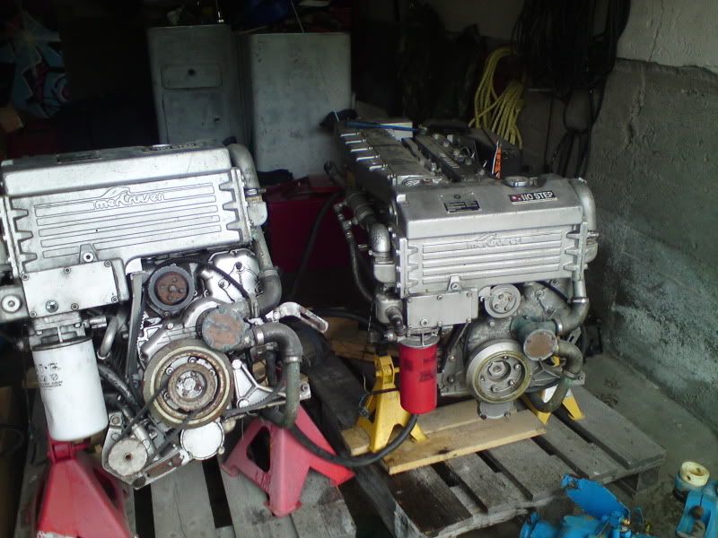

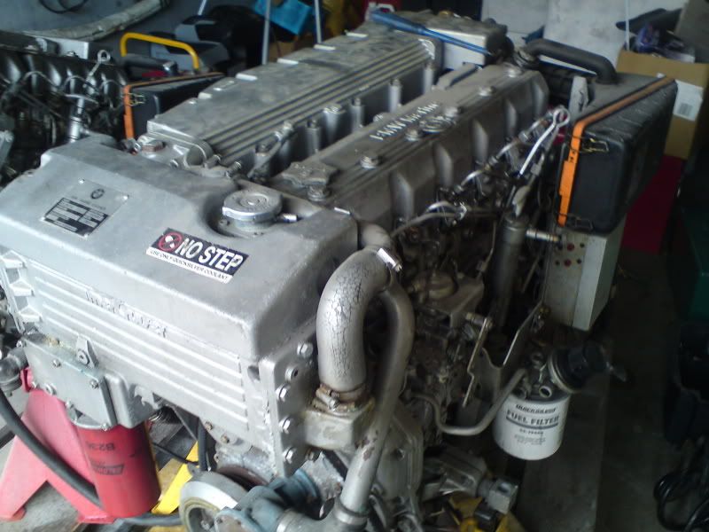

Just a small update: I have got a pair of Mercruisers 220 Hp. But they came without gearboxes. And here I´ve got some problems: My gearboxes from the "True Blues" Crusaders don´t fit in on the new engines. I need a couple of new Flywheel Housings, maybe with starters on. The next problem is both the "new" engines are turning left (seen from flywheel side). The old Blue was one lefthand and one righthand. Any suggestions out there?

You need to get a difrent set of gear boxes , the type that wil take full power in "reverse" postion you use that ro reverse the direction of the prop . your not really running them in reverse your runing int the "B" postion and the other engine will be in the "A "postion .
Your current Velvet drive (I asume that what you have) won't do that ( WILL BURN OUT REVERSE) ZF & hurth are 2 gears that will work
You need to find out what bell housings you can get then find a gear that will fit it as there are difrent housings ( #1 ,2,3,4 etc )
