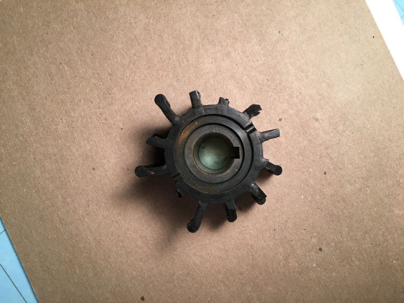

It's in! It floats! It's dry! .... but a bit too dry... starboard engine isn't pumping any water. So had the pleasure of doing the maiden voyage of the year (1.5 mile trip from storage facility to docks), and docking, on one engine. Crossing my fingers that the impeller just took a set over the winter.

.... once I get a new impeller... thought I had a spare on hand but can't find it!

Captain, don't forget to back flush your oil cooler if that impeller came apart. Good luck. :wink:

Got in to the engine this past weekend. Pulled water pump apart and YAY - found this:
Apparently, the impeller did not just take a set....
One vane still intact, the other 11 f'd up. Part of one vane stuck in an output port of the water pump (but of course sticking down into the pump itself, so it could shred all the other vanes off!!!) Tried to pull whatever hoses I could. Found inboard manifold had a partial vane obstructing it (from years ago - doesn't match up to the impeller). Couldn't pull outboard hose - just didn't have the strength, so hope it's okay. Pulled t-stat housing and found 3 impeller pieces stuck in the fitting.
In total, found 85-90% of all impeller parts. Know I should find 100%, but hoping I found enough that is shouldn't be a problem. As I said, one part I found was from a previous impeller, so hoping that means I can get away with some tiny pieces not causing too much of an obstruction. Will definitely be watching the engine for the next while though.

For what it's worth, I sort of disproved the impellor "set" theory a few years back. I used to think the same thing based upon what they look like when you remove them. I changed one and the vanes were all curled over. I threw it in the trash and about 1/2 an hour later a fellow boater came by and asked what I was doing. I told him that you really need to be on top of the impellor maintenance because the vanes take a set if unused.
I said, "look at this one" and reached into the garbage. It looked brand new! All of the vanes returned to their original position in less than an hour. I kept it for a spare because it was otherwise perfect.
