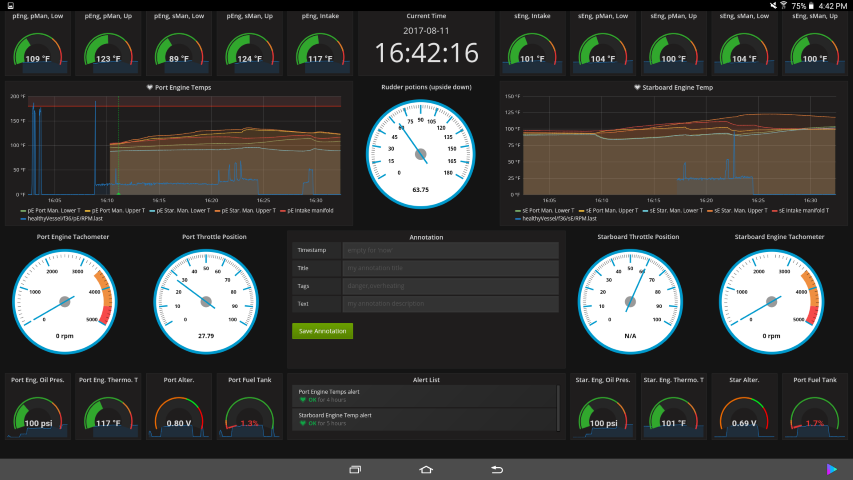

I got the RS11 working today along with the other temp sensors. I tried to take a video but got caught with another issue the reflection on the Samsung tablet did not play nice i will have to get an anti glare. Its not so bad when your using it but on my phone taking a pic or video its awful.
I have a attached a screen capture which is about 20 minutes int a start up and various dables with the throttle.
This is with out calibration: that is to say im simply setting the gauge conversion so that it takes 1-12V and converts this to 1-100 and 100-1 for the fuel.
I will have to tweak further but will need to run the boat as each gauge is a scale (other than voltage of course).
Also i solved the wireless performance. I printed new cases for both Engine and the base station PI''s allowing more holes and in the change other realized that the base station PI the wireless antenna had actually broken of the board on one sire (probably got dinged by a screw driver while being screwed down or a poor solder?) any way i switched out the PI and everything is working well now.
This is with a 2 second refresh, i also tried 1sec and things also worked well. I added the RPM for both engines to the temp historic graphs so i can see cause and effect. The RPM for both engines on the historic graph is set to divide by 10.
Both engines were of when i did the screen capture.
Its also important to note that the rudder and throttle positions are not working yet and just pumping out generic random data.

So what you are saying is that you've managed to emulate the data stream that you would capture if I was trying to dock?baggins wrote:
But really, excellent effort here. Please do continue to post your work, since after three decades or more, most of the steam gauges are ready for an upgrade. So far so good!

The data im generating until i install the potentiometers for the rudders and throttles is just random data fed at the same speed as the RS11 and Temp gauges.P-Dogg wrote:So what you are saying is that you've managed to emulate the data stream that you would capture if I was trying to dock?baggins wrote:
One of the challenges I find when maneuvering (docking) in high flow areas is "knowing" the current position of the rudders and also when cruising and trying to balance the thrust of each engine equally (i know there are better ways to do this automatically) but thought it would be cool to know the position of the rudders the throttles (may be a more difficult) would be a nice to have.
