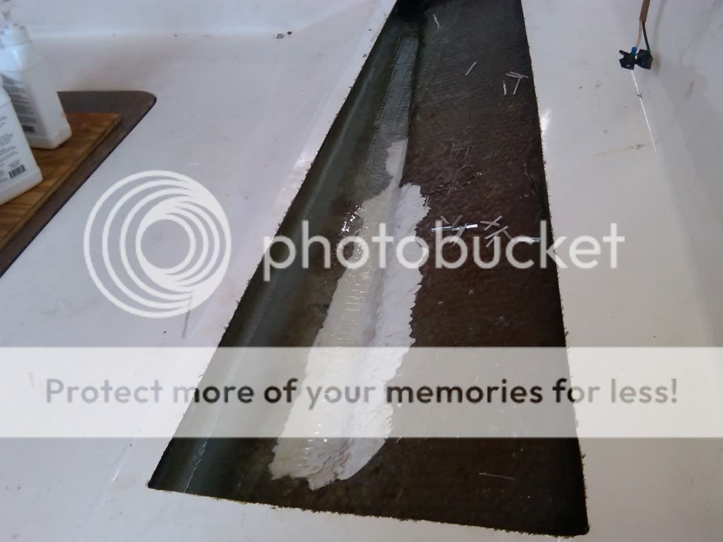

Well I made some progress after IDA cleared out of here.
Applied 5200 under the stiffener.
http://i853.photobucket.com/albums/ab96 ... 1-1407.jpg
Then used some thickened epoxy and filletted the angle between the stiffener and the hull, then lapped the hull to the stringer. I still have some sanding to do to get rid of the patch but that will be done out of the water.
http://i853.photobucket.com/albums/ab96 ... 6-1229.jpg
