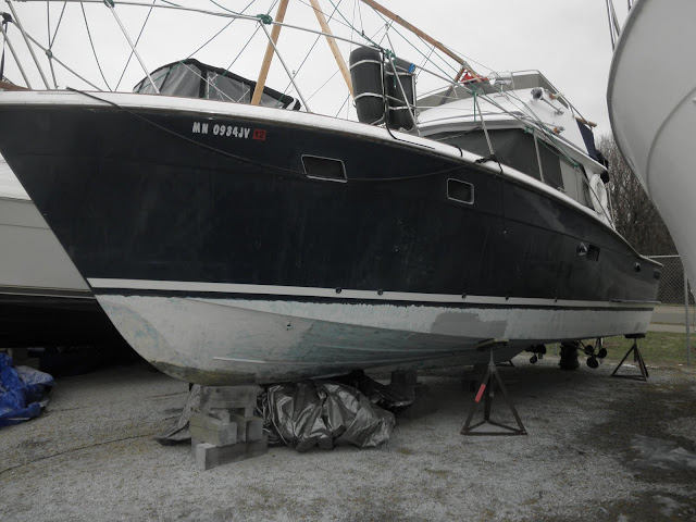

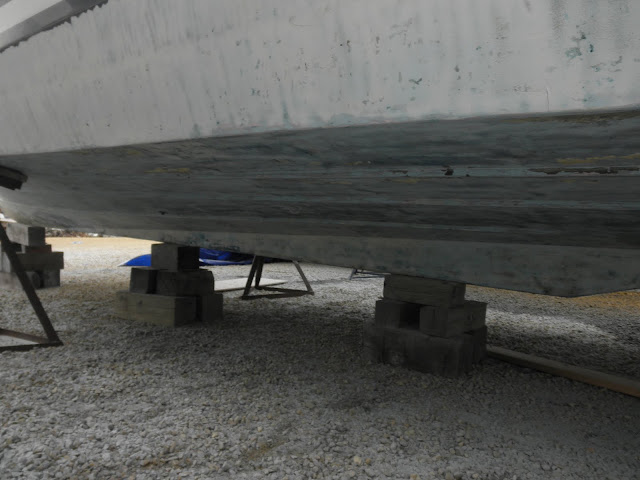

Warm enough to work in MN finally so we Soda blasted today. I'm VERY happy with the results. Took about 3 hrs. Cost $525 but I twould have taken me 6 weekends and just about as much in sand-paper + I'd have to breath all that nasty stuff. less than 5% of the surface has gelcoat exposed. It looks like someone rolled on a barrier coat of epoxy at some point in the old girl's life. The blasting took it down to that layer.
I have some scratches and cracks to fill, but I did not find a single blister. BTW, the cracks are in the surfaces of where repairs have been made before. It looks like somone used a non-epoxy based filler in a few spots. I'm going to grind all of that out and do it right.
Here are some before and after shots. (BTW, the before shots took 3 8hr days of work with a pressure washer to get it to this point):

lamdvf36, Have you had a moisture meter on it since your hard work? I have asked this of others and find a lot of guy's do not check before barrier coating. Save yourself a lot of grief. Check moisture levels. Just saying :wink: jimbo36
