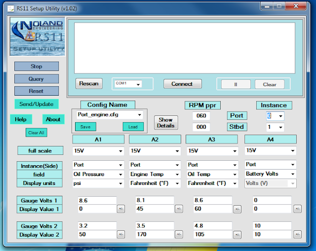

I think you can put up to 10 of these on the buss. Below is a screen shot of the setup program. In the "Instance" drop downs, you can select up to 5 devices per port and starboard or 10 of these units. There are pre-sets configs in the software for gasser and diesel single and dual engine setups so it does not take long to wire in, calibrate and get going.

Ross, like LandV said, you can install multiple units. The network will know what information is coming from what unit by it's instance or address if you will. Each device must be given a unique instance. Different companies use different terms. Merc uses "city". Though there are IMPLIED limits to the number of sensors one can install in a network, there are technically legal ways to get around them. Having said that, I think for our types of vessels, we have nothing to worry about. The bandwidth on N2K is enormous so it can handle a ton of information per second. The only thing I have to add about adding a lot of sensors is that the devices are powered up by the two power supply wires in the backbone. Since most backbones installed are to run a given manufacturer`s devices such as a diplay with sounder, radar, GPS modules etc, the supply wires in the backbone will typically be of minimal gauge. As such, when going beyond a typical nav installation, one must consider how much of a power load will be placed on the existing backbone. Devices should have a LEN (load equivalent number) or a current draw lable on them for this reason. Having foreseen the limitless possibilities and sensors that are starting to be introduced, some network manufacturers are now making backbones with larger gauge power supply wiring to accomodate larger loads.
