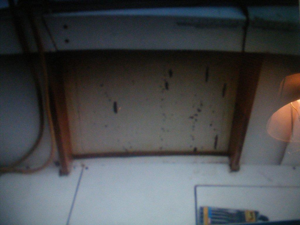

will this have any effect on structural integrity?
no
let's re-word this
I'm sure you have already determined that this will not affect structural integrity.
The question is how would a layman determine this about his own particular vessel?
Re: A small project or what have I gotten into
Yes it will effect it . In a positive way . I have framed in area where the door will be , Also the inner hull liner/deck that was there is now a more structural part of the transom.
I know of 2 other Trojans that have done the something but with out the reinforcements I did with out issues .
How can a laymen determine this ? like the question Can I fix this myself ? It depends on your ability and understanding of what you are doing and how it effects the structure .
I will try and get some better photos the will show some of the reinforcement of the door area . Also Trojan put a cross the stern (rib ) to support the deck I also put another one right at lower part of the door opening and bonded ( glassed ) the deck to the transom .
I was considering the lateral strenght of the entire stern.
port to starboard.
seems like cutting a notch out of this might weaken the port/starboard flexability factor?
Dunno, just a thought.......
But......
What about adding a "U" shaped aluminum member, say 3" or 4" tube welded together and then glassed into the "frame" - built in - integrated into the opening.
Just a thought,
H
The reinforcements are all glass and wood ( mostly marine ply) I could have put a metel U in place , but I saw no need . ( I had thought about it early on use SS) . In fact there was no reinforcement "ribs" above the floor area Trojan saw no need . The inner liner of the transom was just there , not even attached to the transom at all above the floor . It is now part of the stern support system , the area of the soon to be cut out it fully reinforced . I expect the transom to be much stronger then before this project . The planing and design has been well thought out . I have looked at many other doors both factory and refits to see weak points and good points . some were not beefed up much if at all ( factory ) basically a molded in hole in the transom. Other were very much strengthen in this area . Thats the course I took . My design is very simalar to the way Viking did theirs and they have done a few .
