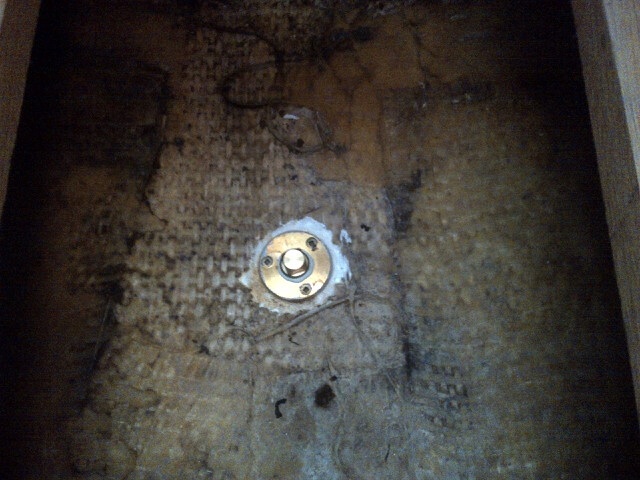

This is a picture of what I did. Opening up the hole and letting the water wash in and out has greatly impacted any smell. I am alwasy dumping either left over deck wash or bleach as well in the back and letting it take it's course.

As promised, not much to look at but,just opened it up to drain and nothing in there----- Mike
- image.jpg (137.42 KiB) Viewed 10914 times
- image.jpg (107.78 KiB) Viewed 10914 times
