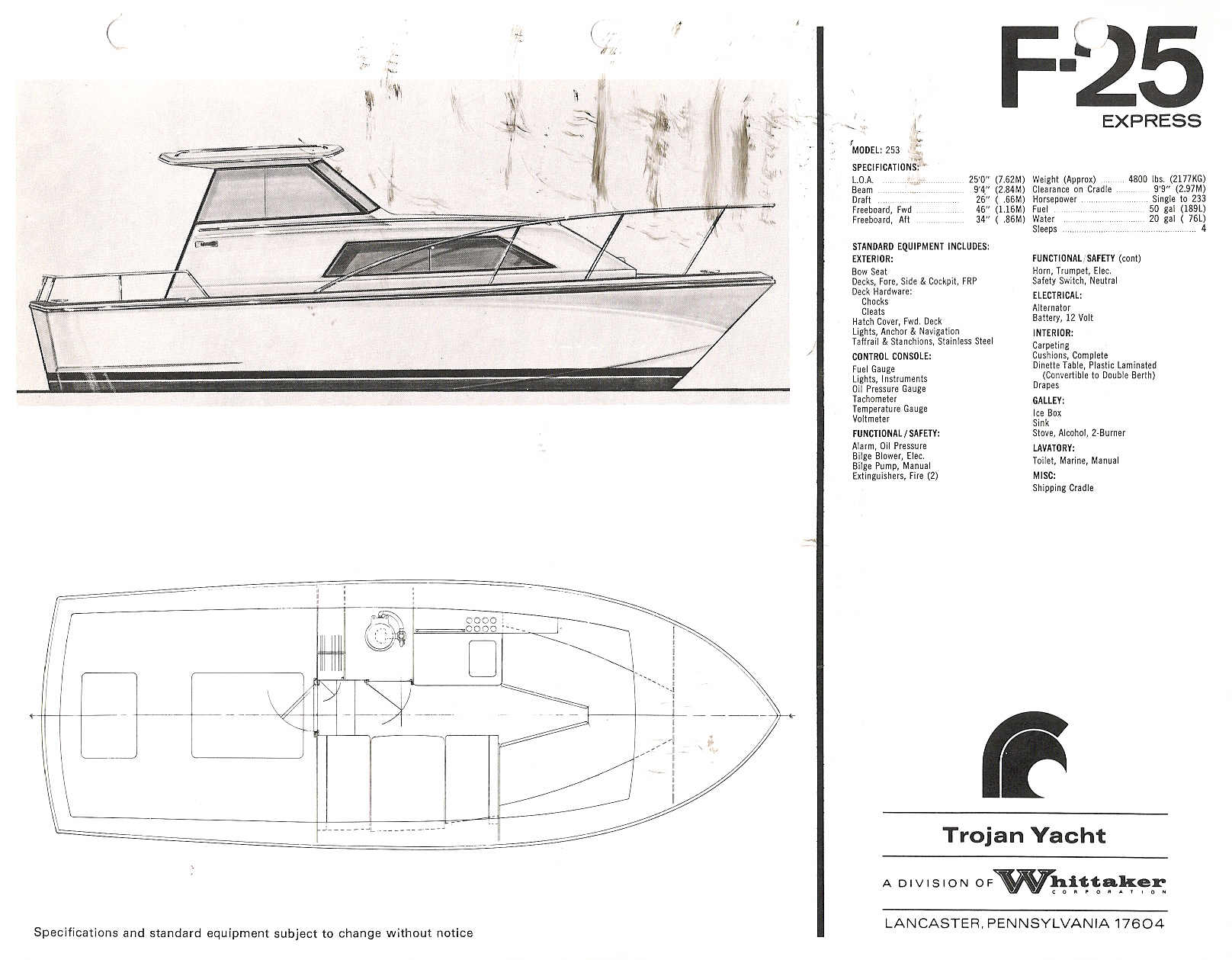

44Ydnar88
Posts: 52
Location: atwood illinois
Re: Msd ignition
Post by 44Ydnar88 »
Mine is a mirror of this brochure,
f 25 Express 2.jpg (148.71 KiB) Viewed 6731 times
