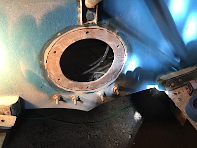

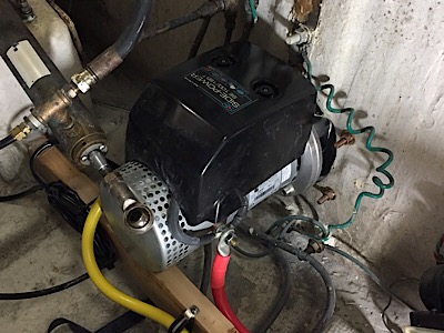

I got the tunnel installed on the transom and today installed the motor and glassed in the support for the motor. I have to run the battery cables and finish up on the control cables including a wireless control which is due in tomorrow.

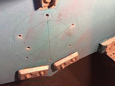

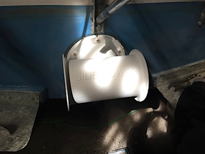

I don't have photos of the tunnel install yet. Just of cutting the 8" hole in the transom. I will try to take some photos of the tunnel tomorrow. I had to build up the port and starboard sides of the hole to remove the camber of the transom. I put wax paper on the face of the tunnel and liberally coated it with thickened epoxy then bolted it at 12 and 6 o'clock to draw it up. Then cleaned up the squeeze out. After the epoxy went off I removed the tunnel and then filled the 12 and 6 o'clock positions with epoxy. Sanded the epoxy smooth and then put 5200 on and bolted the tunnel on.

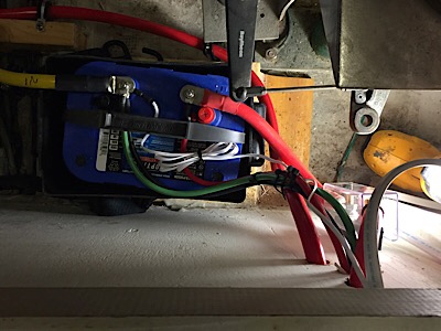

Got the tunnel and motor mounted. Just have to install the battery and battery cabling.

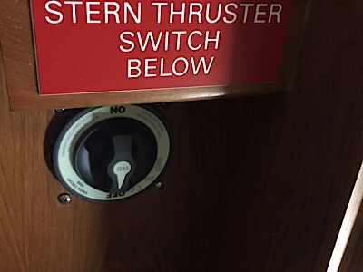

I am almost done with the stern thruster installation. Just need to finish up some small details and pretty up the area of the thruster. Also need to get power to the wireless remote control. The wireless remote will come in handy when docking or locking since my wife handles the bow and I have to get the stern lines after getting down from the helm before the stern drifts away from the dock.

Finished up the installl. Did a quick test with the joy stick and the wireless remote. It works in both directions. Can't wait to see how well it does in the water.
