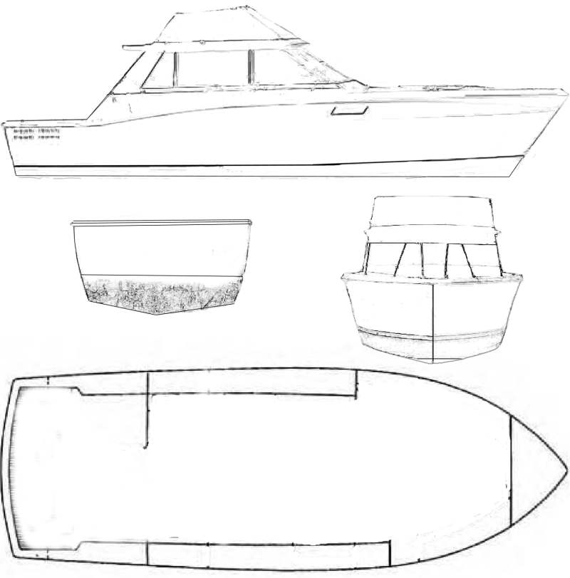

Here's the line drawings I used. They're not fancy because they're just photographs converted to Line Drawings using my photo edit program but they were good enough to get the major dimensions correct. Each of the four views is in the same scale so if you enlarge the page they'll all stay in proportion.
Hope they are of some use to you. Don't hesitate to ask if I can be of help.
Frank
