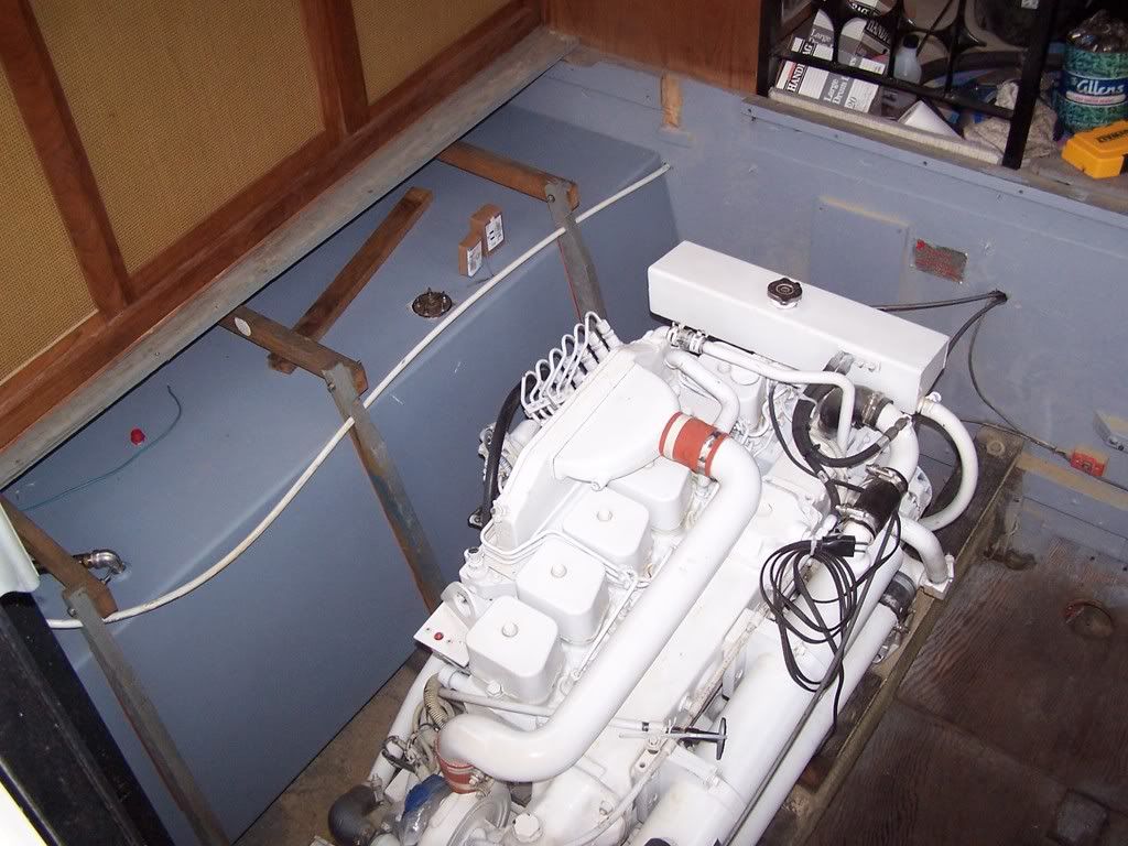

http://i235.photobucket.com/albums/ee26 ... 0_0593.jpg Here's one of the new aluminum tanks in place and framed back in. I still have to add spacer blocks to the top to replace the 2" in height I took off the original tanks. Throttle and gearshift cables are hooked up and rigged....had to reverse operation at the quadrants, gas throttles push...diesels pull. Also had to reverse operation of R/H gearshifter. Easy to do....just swap position of cables on the bottom of the lever. New stuffing box hoses are in with new clamps. I've been planning my exhaust system (photos from Prowlerfish have been a BIG help) and have initial elbows and connectors on order. Exhaust piping will be 5" back to the original 5" mufflers. It appears there will be enough slope from the engine to the stern outlet, but if there's not I have already located 5" water lift mufflers on the net. Hope to finish plumbing fuel system next week and fill the tanks to see if 1. they leak and 2. how much fuel they hold. More next week.

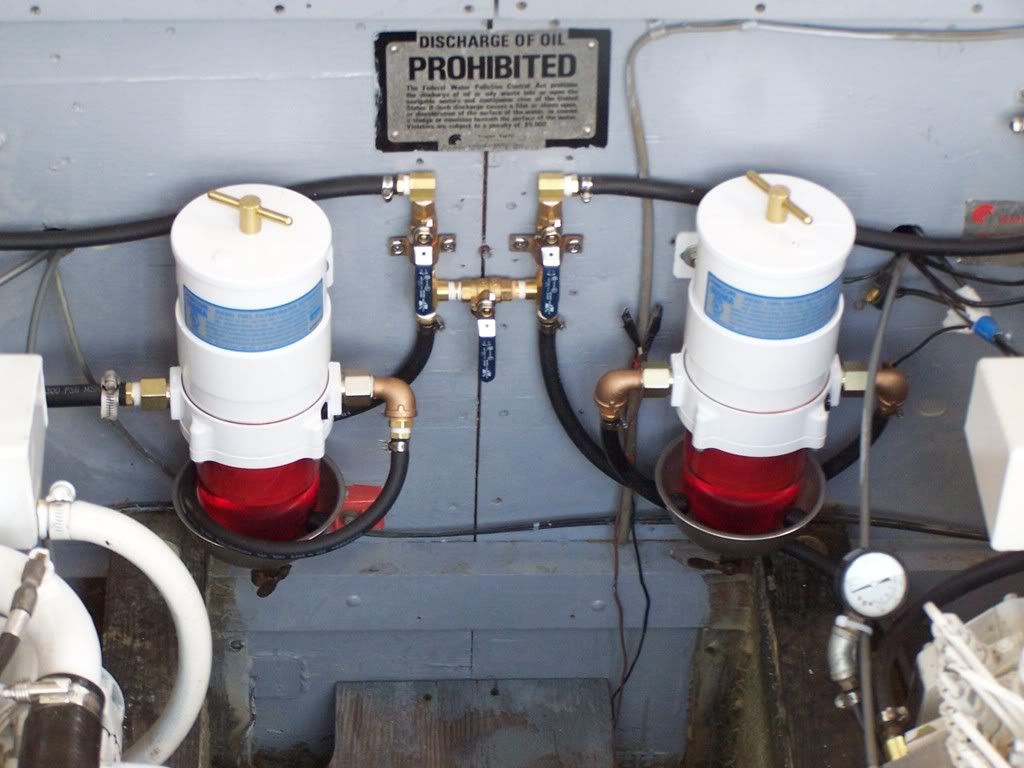

http://i235.photobucket.com/albums/ee26 ... 0_0595.jpg It took two trips to Lowes to find enough brass fittings to build my new fuel manifold, but it and the Racor MA900's are in. Thanks again Paul for the Racor advice...it was right on the mark! The fuel truck showed up Tuesday and filled the new tanks. No leaks, but I didn't expect any as the tanks were pressure tested by the builder. These tanks only hold 100 gallons each as they are not as high as the originals, but I can remove them if I have to without pulling the engines. The UPS truck brought the last two pieces of my exhaust system yesterday (pics later....it looks just like the one on Prowlersfish). I patched in a battery and a garden hose to the raw water pump and fired 'em both up yesterday. No surprises and they were a lot quieter than when I had them here in my shop running. Hope to launch next Tuesday....more later.
