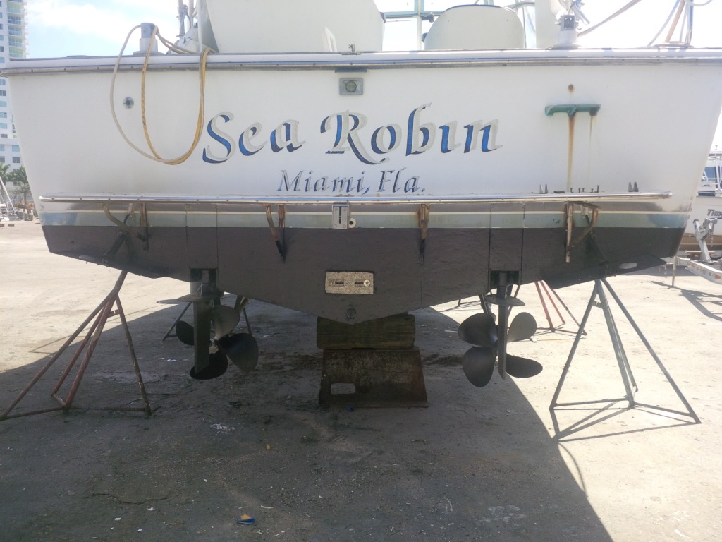

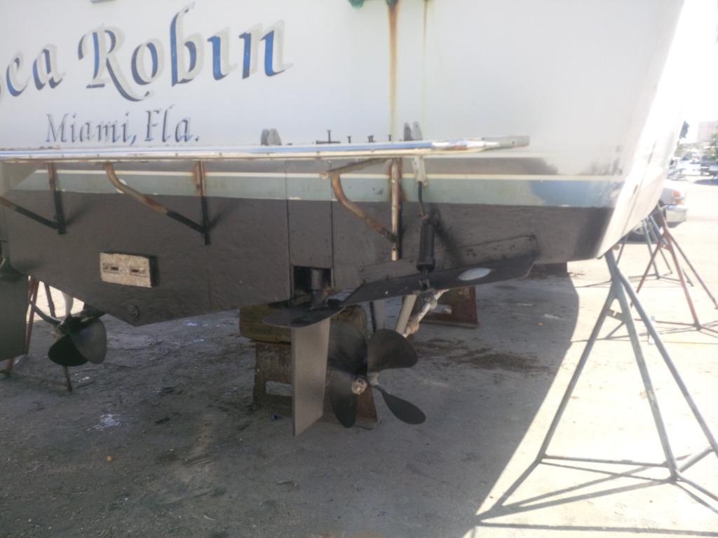

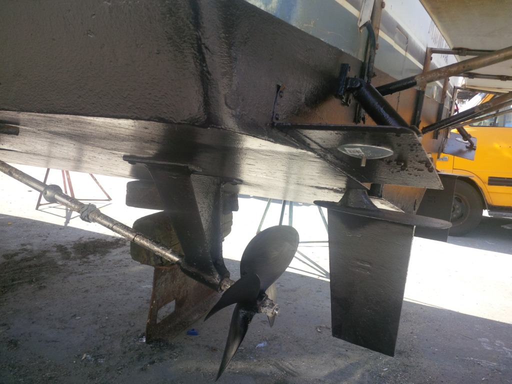

Read this thread with interest and have just spent the past week getting up close and personal with the bottom of my 11 meter. I have several photos which are on point with the trim tab installation. I have stock setup from the factory. When I bought mine, it had approximately 200 hours run time and the previous owner told he had made no changes the boat since he bought at tthe Ft Lauderdale boat show in 1985.
I have 454 crusaders and i have no difficulty getting on plane
