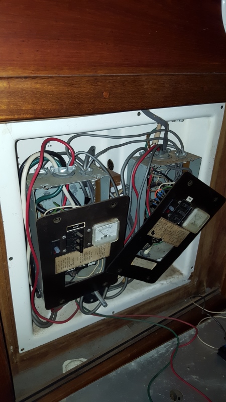

Our F36 has Romex on all the distribution circuits and I suspect it is original. Everything I can see up to the mains is wired with stranded, but that is about all. We actually have two metal panel boxes with Masonite covers on ours:
AC Panel.jpg (167.38 KiB) Viewed 24505 times
Like oilandwater, a new distribution panel and wiring is on the horizon, just not sure when.

WayWeGo wrote:Our F36 has Romex on all the distribution circuits and I suspect it is original. Everything I can see up to the mains is wired with stranded, but that is about all. We actually have two metal panel boxes with Masonite covers on ours:
Way, ouch, that must have hurt opening up those panels.

Kind of strange how how the 73 and 77 are close to the same and the 75 is different . I guess one of the panels on way we goes 75 may have been added maybe by the dealer maybe the factory ?? I saw a early F36 that had 2 panels one on each side , as were the cords .
