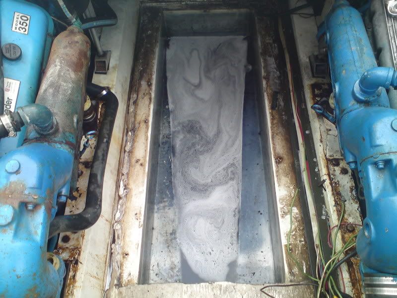

The holding tank. It was a terrible job to clean it up. Here is the third washing, and the last one. Tomorrow I will paint it white.

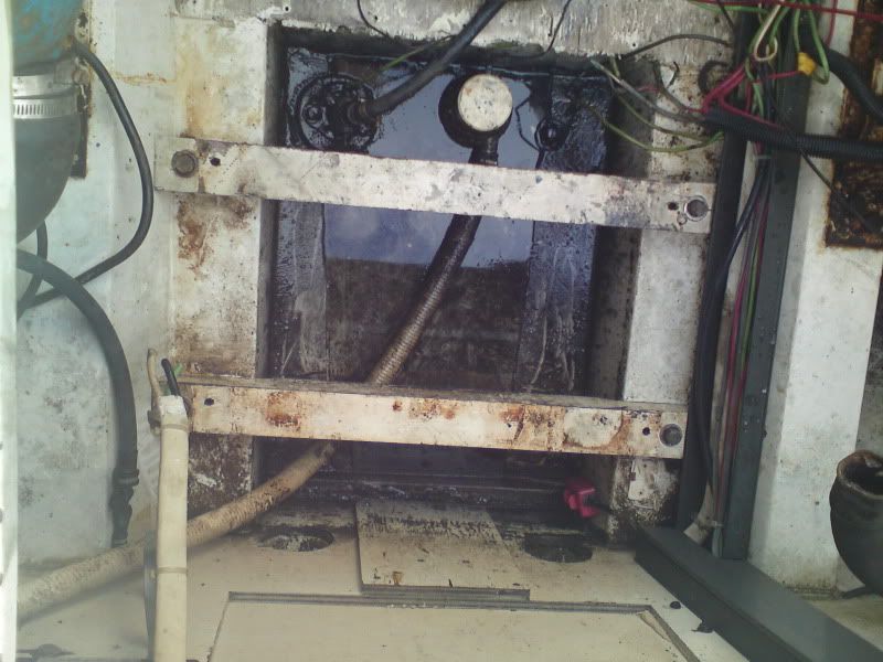

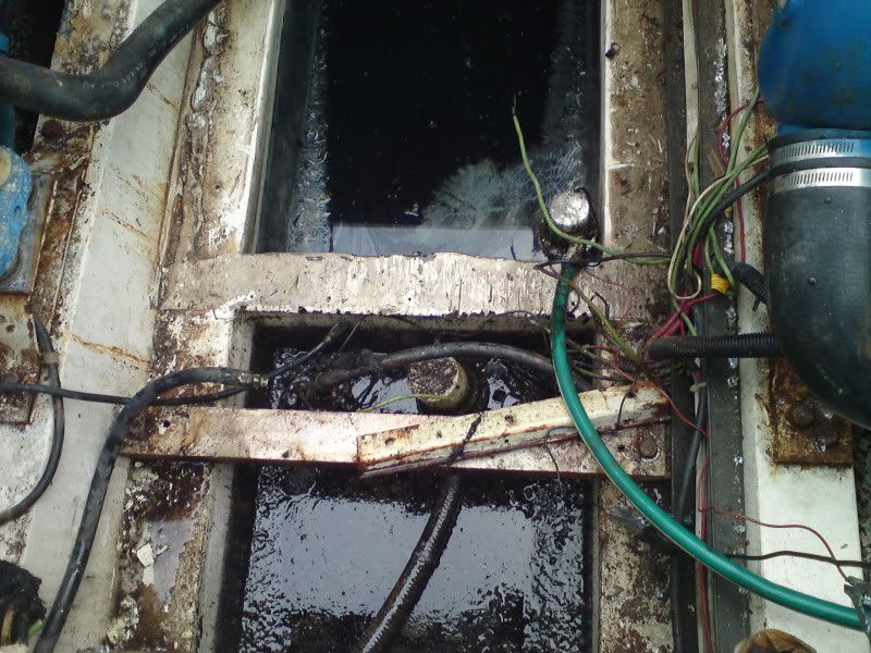

The well under the GenSet. I will dry everything here, and paint it white. At last I will put up a Battery Bank with 3 x 200 Ah batteries here, on top of the beams. I will also change the bilge pump and hose to a bigger size.
On top over the holding tank I will lay an acryllic lid 1/2" thick, as a floor in the engine compartment. I will also put in inlet and outlet tubes.
PK,
This boat has three bilges.
One bilge pump in each bilge.
The "well" under the gen set is the center bilge.
This handles all the water from the engine room.
All three bilge compartments and the entire bilge need to be debris free. You don't want to stop your bilge pump which is designed to pump WATER not TRASH.
This boat was originally equipped with SIX bilge pump switches, one each for the pumps and one in each bilge compartment to trighger the bilge alarm which is wired into the vessel's horn.
You will find the alarm wiring running along the starboard side of the inside starboard stringer.
Good Luck,
