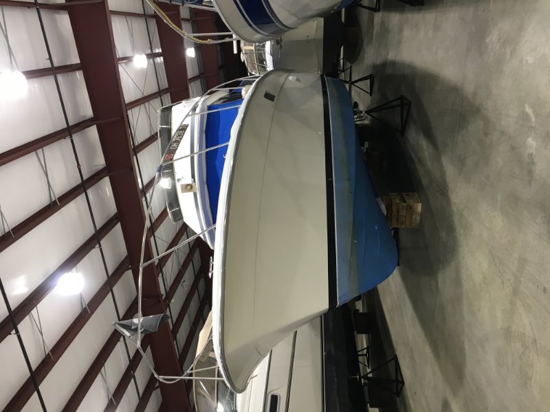

I appreciate the concern about the cinder blocks but my marina has taken excellent care of my boat so far. And I am a Builder/Contractor/Project Manager and you do point out an easy mistake anyone could make. Cinderblocks are only meant to stack in one direction. With that being said if someone stacked them with the hollow face showing then you will have serious problems. If stacked the way they are designed to stack the will not crumble... As are the ones supporting my boat are stacked correctly I'm not concerned at all... My boat was stored on proper cribbing all winter just FYI

The issue with concrete masonry units is one of point loading, assuming orientation is correct as noted by OP. Theyre great for carrying distributed loads. Concentrated loads, as would be the case if a pebble got between two blocks, not so much.

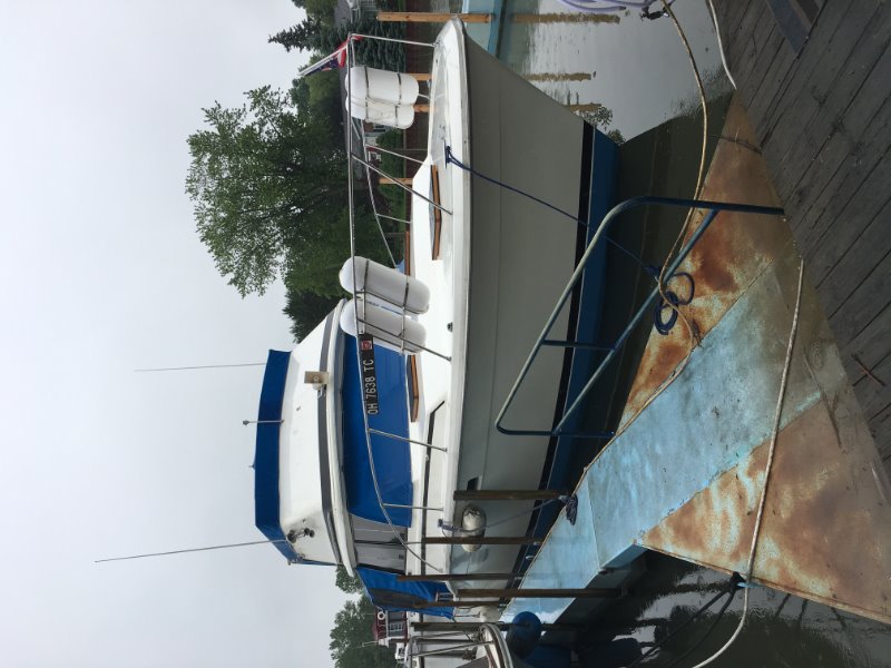

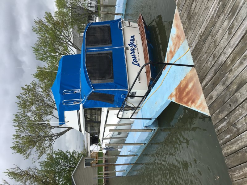

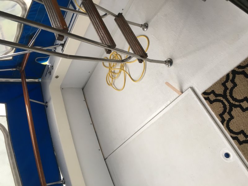

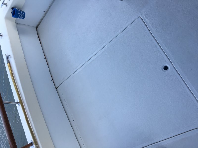

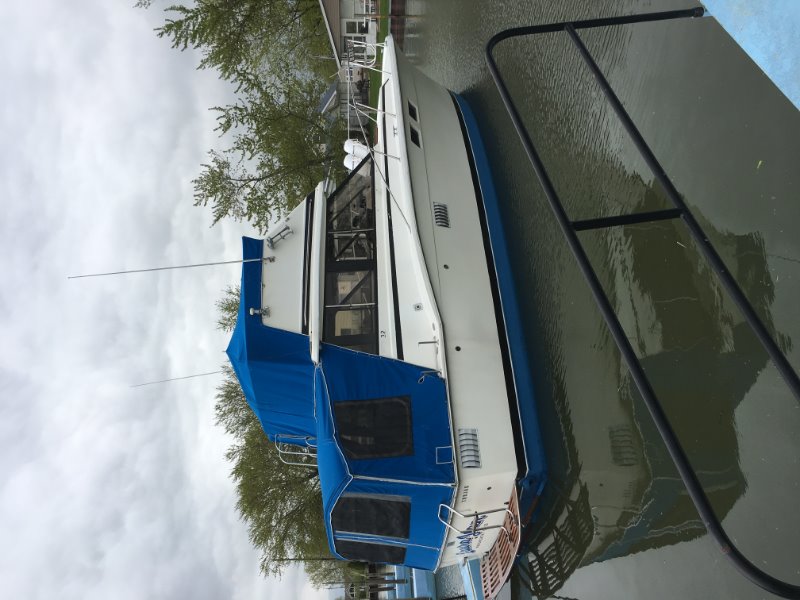

Had a productive weekend. Finished the non skid on the cockpit deck and installed the recovered combing panels around the cockpit. Also checked out the trim tab pump and topped off the fluid and low and behold the lower helm switches are reversed. Is there an easy fix? Swap wires at the switches or at the pump? Anyone ever had to do it before. And we got her in the water this afternoon and she started up and ran like a dream. Due to cold weather we didn't venture out to far but it seems all is well.

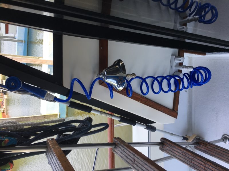

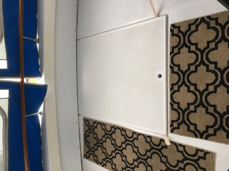

Ok been busy with a bunch of little projects and also enjoying being on the boat in the water. I changed all the light fixtures to LED lights, WOW what a big improvement. Doesn't feel so gloomy at night... Pulled up the galley floor for a quick look and all is good under there, then screwed the panels back down. Still trying to work out some electrical gremlins but I think I have it narrowed down to the hot water tank and Princess stove/oven. Anyone else having trouble using there stove? It works for about 5 minutes then the shore breaker kicks off. And I only used one stove top burner. I also ran hot and cold water to a faucet in the cockpit for washdown of the cockpit floor and so I can get a quick rinse off when I'm working on the boat.
