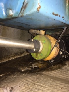

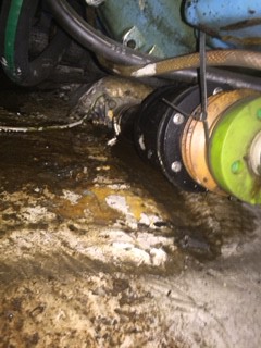

I noticed that my bilge pump kept cycling on and off, so I tracked down the source. It appears that the starboard shaft seal is leaking. How is this replaced and how do I figure out what replacement bellows I need. Does the boat have to be pulled to replace? Feeling very nauseous all of a sudden...

I have repacked regular stuffing boxes in the water, but I think with a dripless you have to come out to replace parts as they are all attached to or around the shaft. I am curious - what's the zip tie there for?

I have no idea, my thoughts exactly. There is not just a lot of room to work or even look. I had to stick my phone down there and take a bunch of pictures to even see what was down there.

I finally figured out that it is a Duramax seal. they have a replacement bellows and seal kit. I will let you know how it turns out.
