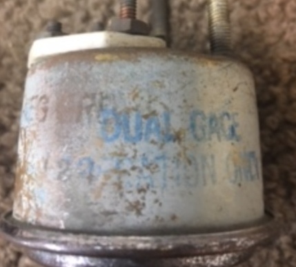

1. You can identify a Delco gauge by it's tin backing. Delco gauges do not have plastic backs.
2. There are two types of Delco gauge - a single station gauge and a dual station gauge.
Delco gauges are are also stamped as 'Single' or 'Dual' on the side (see photo)
3. Each type of Delco gauge has a single sender. For example, Delco fuel gauges must use a Delco fuel sender. The same applies to
engine temperature and oil pressure gauges. Note: A Delco sender will power either a single or a dual gauge system.
4. Trojan used either white needle or orange needle Delco gauges.

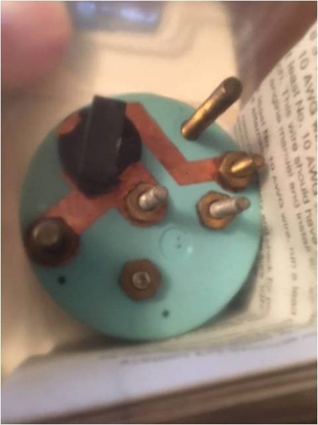

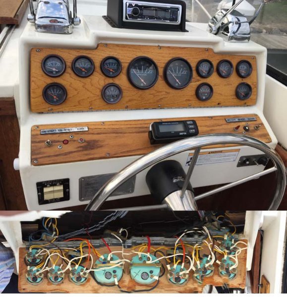

Very helpful - I would like to replace my gauges. I know gauges differ by the type of engine and drive. My gauges are plastic backed and green see attached. Do I need to replace the sending units when replacing the gauges?

Your gauges will need to match the senders .You may be able to get gauges with the same specs. I don't believe your gauges are the original . Any close ups ? If I zoom in they get blurry
Re: Trojan Gauges 1970-1980
Why are you replacing them ? Any issues

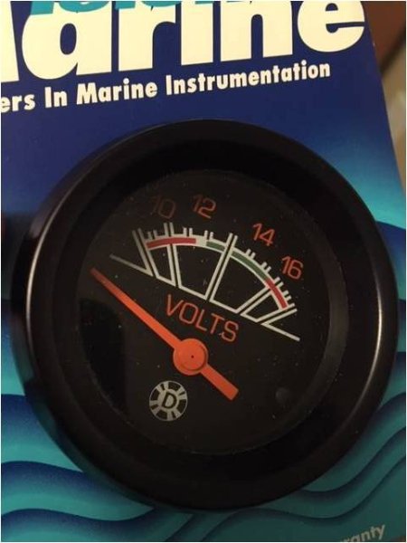

I believe those gauges are original as they match what was originally on my '79 F32. I understood they were 'DetMar' gauges - Detroit Marine - but have never been able to confirm it. I replaced mine with some new Teleflex gauges that were compatible with existing senders.prowlersfish wrote: ↑Mon Oct 22, 2018 6:45 pm Your gauges will need to match the senders .You may be able to get gauges with the same specs. I don't believe your gauges are the original . Any close ups ? If I zoom in they get blurry

It was way too long ago that I don't remember... If I remember correctly there are 2 primary types of senders - one is based on current, the other based on resistance. What I replaced the old gauges with was Teleflex Red International, which worked with whatever senders I had. I had a tach blip out a few years later and replaced them with new Teleflex Amega ones (since Red Internationals were discontinued by that point).
