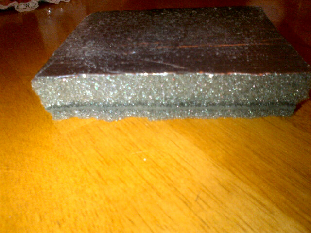

Here is what I used, can't remember the name though, comes in sheets or a roll and is heavy.This is fire rated and works for heat and sound.
- layer inside
- IMG-20180219-00241.jpg (100.75 KiB) Viewed 14341 times
- IMG-20180219-00240.jpg (104.67 KiB) Viewed 14341 times
