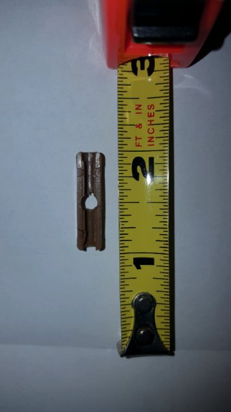

This is what the slider that attaches to the bottom of the door looks like (the hole in the bottom is broken out where the nail mounts the slider to the door):

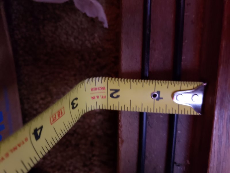

And these are the tracks that it slides on:
The tracks are installed in slots cut into the wood that forms the bottom of the door opening. In this photo, the trim on the outside of the door opening is to the right with the tape measure butted up against it.

Now I got it... Thanks Way We Go that helps a lot.. As a matter of fact I found a few of those in a drawer and wondered what they were for... But right now nothing gets thrown away till I know what it is.. thanks agian
