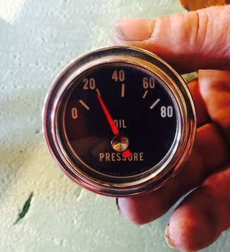

Going up when turning off the key/power , is not abnormal on some gauges . 80 psi seems high cold be the wrong sender . Can you ID the gague brand ? if oem they are AC .
http://www.trojanboats.net/wforum/viewt ... =1&t=10222
Notice where this gauge is at , not even hooked up
http://www.trojanboats.net/wforum/downl ... hp?id=2053

Gauges like Delco, Datcon, Telaflex, and others the needle all will float back to the center or some wear else when the key is turned off.
When the ignition key / switch is turned on all the gauges should come alive and present themselves correctly.
Your 1977 Trojan F-32 came with Delco Gauges. If the oil gauges on both engines are reading 80 PSI then something is wrong. Most likely you have the wrong oil senders installed.

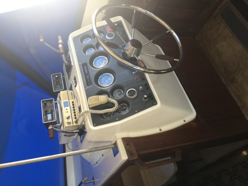

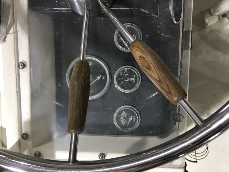

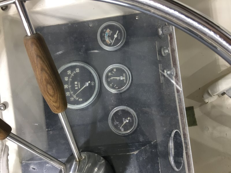

Post a picture of your dash ( Upper and Lower)

Thanks guys, All the other gauges seem fine. They are all original gauges and now that Prowlerfish posted the picture that's exactly what my gauges look like. I'll look into the sender units but from what I read they are obsolete correct? I have to change all four gauges and senders correct?
