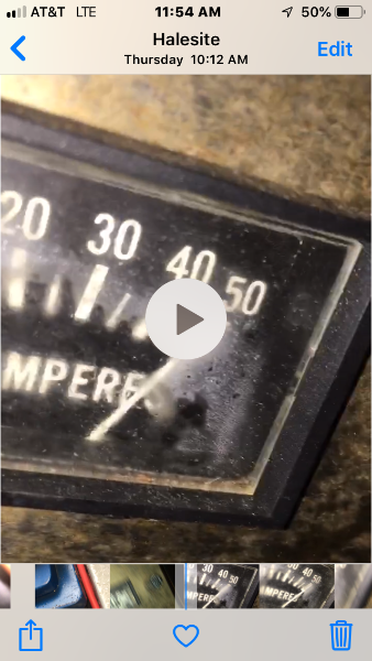

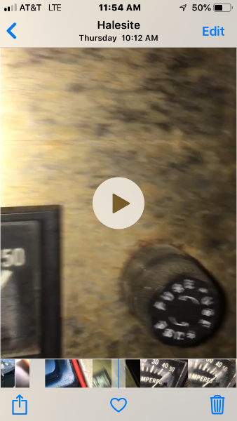

I just installed two new 8D batteries (D is for damn these are heavy). They came with the boat and the stickers show I got 5 years out of them.
I have the original battery charger on the boat. I want to switch to a smart charger but I'm overwhelmed with the amount of options out there.
Anyone have a good charger recommendation. I want to save my recent investment and my back. Boat is plugged in at the marina and plugged into the house during the winter. I don't think what I have is a smart charger. Here are two really bad pictures of it. I can't find any identification on it to see what it is. It just has a gauge on the face with a fuse holder next to it.

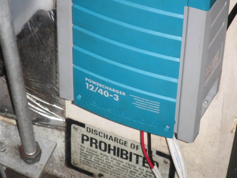

We really like our Mastervolt 12/40-3
We also added the remote monitoring for it.

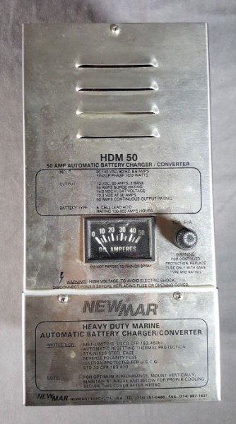

I tracked down what was in there. Made by Newmar HDM-50.

I opted for a ProNautic 1240P. It was about $400 and comes with a 5 year warranty. It's also the same unit marketed under Sterling.
I have Flooded 8D batteries. This has a feature called Equalization mode aka Desulfation mode that will help these batteries if you opt to put it in this mode for 4 hours.
One full day to tear out the old and install the new.
The old charger had terminals bank1, bank2 and bank3. Only one bank went to the batteries, they are in parallel.
There were two other wires that were on bank1 and bank2 that appeared to head back to the main 12V panel in the galley.
I'm not sure what to do with those yet.
It seems that it's duplication. If the old charger went to the batteries, and the batteries feed the panel, why would there be an extra set of wires going to the panel directly from the charger?
I can only guess that if the batteries were removed, you could still have 12 volt power. Thoughts?
