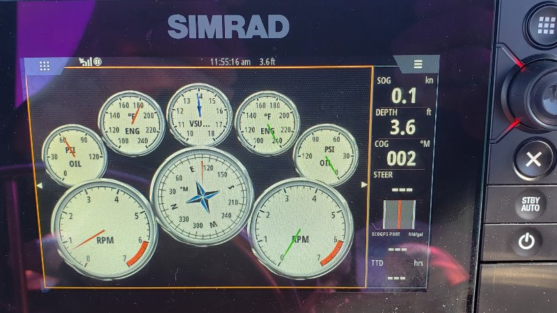

Here is what the gauges look like on my Simrad chartplotter. Only the port engine was running when I took the photo.

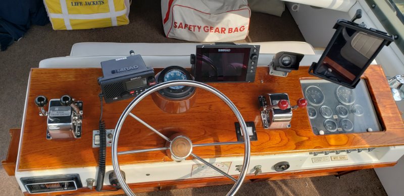

On our F-36, the flybridge helm gauges are in front of the other seat and not in my direct sight when operating the boat. I have to lean over to see them, so they tend to be overlooked when I am busy. Usually, if there is someone in the other seat, I tell them where I want the gauges to be and ask them to look at them often and tell me if we have a problem. Most of the time, that works, but not always. With the MFD monitoring the gauges also, that increases the possibility of finding out about a problem before it gets serious.
My chartplotter at the flybridge helm is a Simrad NSS Evo2, which makes it easy to check the gauges. I have to push two buttons to switch between the gauges and the radar (my most often used screen). My primary navigation is done on an Android tablet running Navionics, which gets data from the NSS Evo2 by wifi.

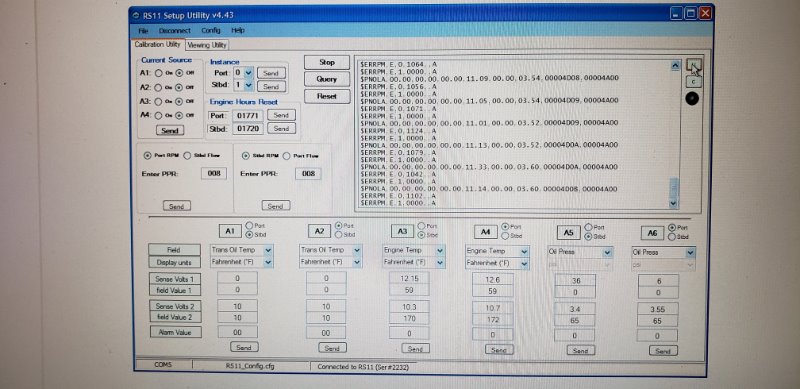

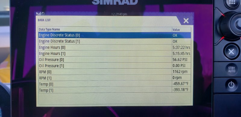

Good question! I was using a high quality infrared thermometer on the thermostat housing to get temperatures and recording them with the voltages I saw on the RS11 configuration utility. Since this type of temperature sensor is not linear, you have to record a range of temperature/voltage pairs and pick two in the area you are concerned with. In this case, I picked values at 105 and 180 degrees F. You input these into the configuration utility and it calculates the equation of the line that passes through these points and sends that to the RS11 so that it can calculate temperatures from voltage levels.
To check it, I used my helm gauges as a rough test to make sure I was in range. They are only graduated in 40 degree increments, so not that precise. Also, my chart plotter can display actual readings through its settings menu so I could verify that the temperatures it was seeing corresponded to my infrared thermometer readings.
Here is a photo of the configuration utility:
And here is a photo of the data display in my chartplotter's settings menu:
As you can tell, these photos were taken with only the port engine running and were before we resolved the issue with the AC Delco gauge voltage levels.

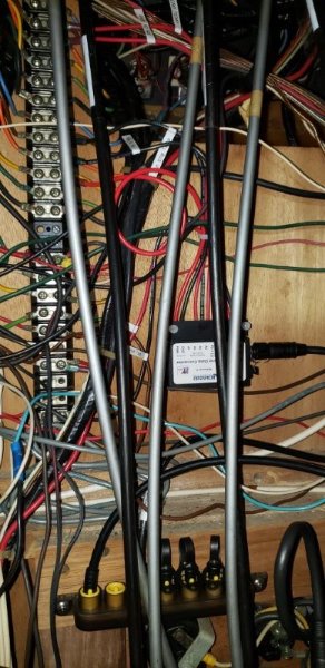

Looking over this thread, I realized that I never described how I connected the RS11 to the physical gauges. The RS11 is mounted behind the lower helm and the connections are all made to the terminal strips installed by Trojan.
