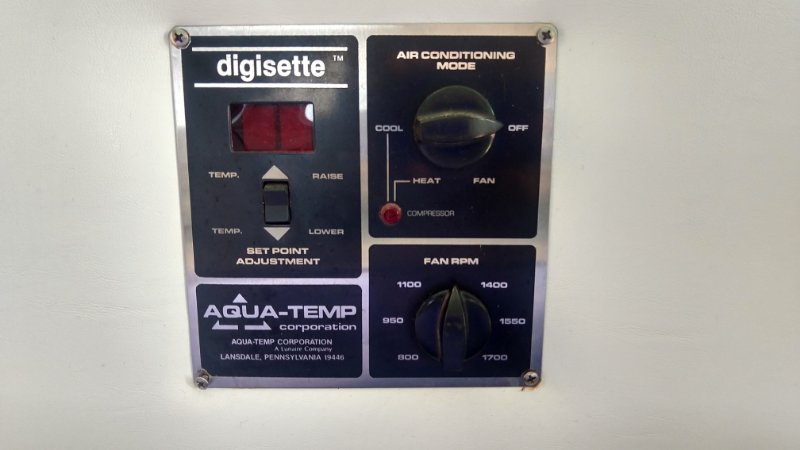

- Old AC system controls

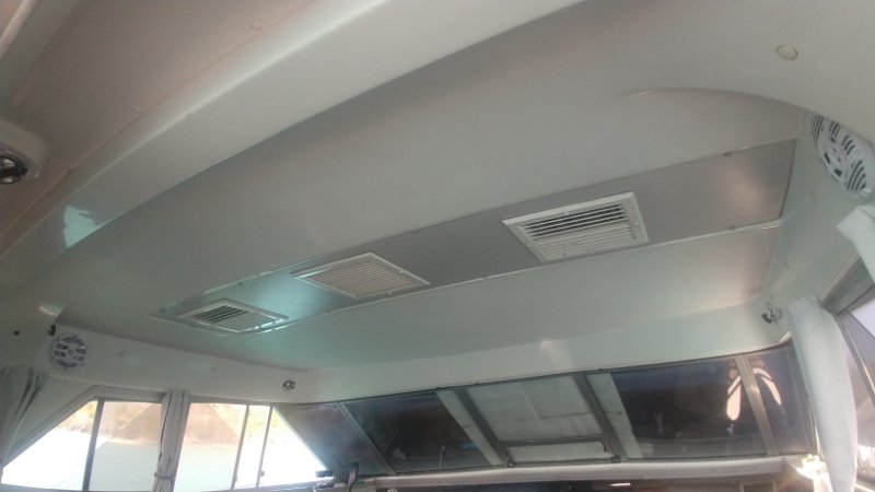

- Salon overhead vents

Would you even have room over head ? Likely need a bigger water pump that can pump that high . And you will need to run water lines and a condensation drain . Self contained A C units can be nice just not sure it would be a good fit there .

There is not enough room in the overhead in the salon of a 10 meter sadan to but a self contained marine AC unit up there.
If the compressor is bad just change it out. A new compressor will come with a new thermostat controls. You would not need to put new copper lines in.
Changing out the compressor will be less expensive then any other option. Especially trying to do some kind of retrofit.
If there is something wrong with the overhead AC exchanger we have a complete new one.

There is a leak somewhere in the system. I do not know where it is as I haven't thoroughly checked yet, but there is absolutely no pressure in any of the refrigeration lines. I'm thinking it could be somewhere in the 35 year old copper lines for ALL of the pressure to be gone.prowlersfish wrote: ↑Sat Apr 18, 2020 7:54 am

Thanks, that's the advice I was looking for. I was hoping someone would chime in and say that they've added a self contained unit in the overhead without issue, but I guess that's not the case.BeaconMarineBob wrote: ↑Sat Apr 18, 2020 8:51 am There is not enough room in the overhead in the salon of a 10 meter sadan to but a self contained marine AC unit up there.
At least now I know the path I should be taking.
