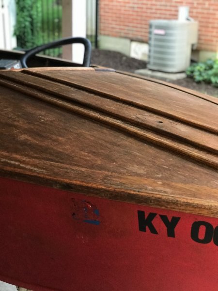

My man and I just recently bought a 56 Sea Queen...
We truly aren't boat people, but Rob is a woodworker and a mechanic - so the project is in pretty good hands!

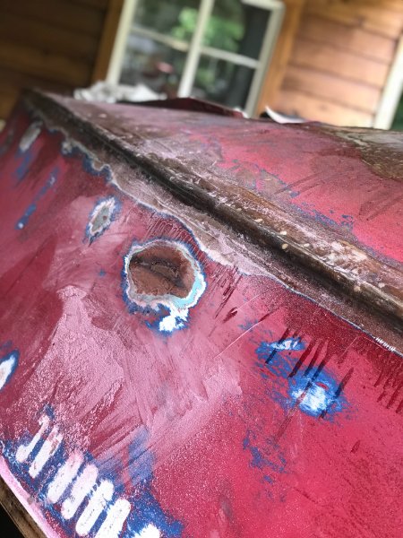

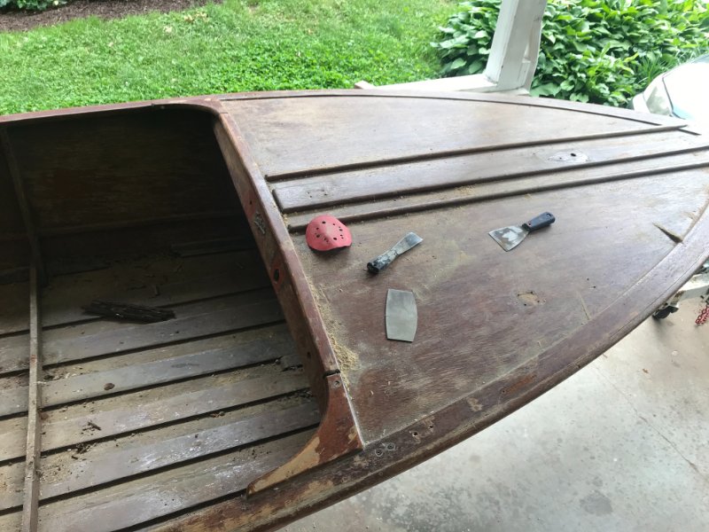

We have been working to remove the old varnish and sand down the bottom.... Rob has used epoxy on the bottom were there was some damage... next step is to paint the bottom and varnish the top.
I have gone down an exhausting road of research to try to learn more about bottom paint, etc. Rob's brother, who has built boats typically uses a latex paint.
Just wondering if anyone out there has a specific brand recommendation - we are simple folks who want the boat to look nice, but we are not looking to completely refurbish.... we want to do a good job, but more importantly, we want to get it in the water and have some fun with it!
Thanks in advance for any suggestions :)

We have sanded down the boat - but not to the bare wood. Since it's plywood, we plan to re-paint it red or white - probably red. Rob is sealing some "mushy" spots with epoxy and fiberglass (?) (stuff that reminds me of stiff gauze). We plan to varnish the top side.

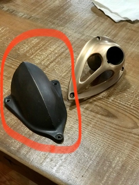

I have another question now... can someone tell me what these are and where they belong on the boat?
Re: Sea Queen Fixer Upper
I am thinking they are a hull drain and there are more parts that go with it . It reminds me of the drain I had on a 1956 Wagemaker I had .But I could be way off . I forwarded the photo to Trojan expert .

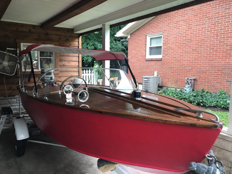

We took "her" out on the water for the first time.... and had a very successful trip! There was very little water - possibly just from our shoes... we are getting to know the boat and growing more comfortable with launching etc...
She looks awesome in my opinion :)
Glad its working out and you are enjoying her . Great seeing classics on the water . Looking good .
