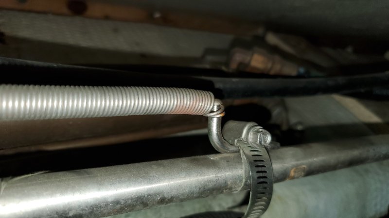

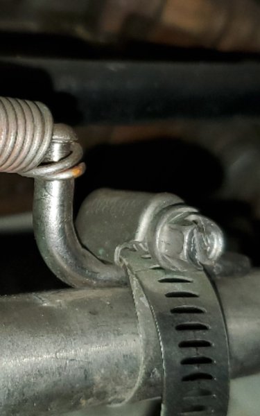

My 1990 Express also has the hose clamp. The end of the spring has an "L" shaped attachment that is clamped onto the tie bar and can be moved on the bar to adjust the rudder angle indicator. Ex: if your indicator is showing port 10 while u/w and straight, you can loosen the hose clamp and move the spring until zeroed.

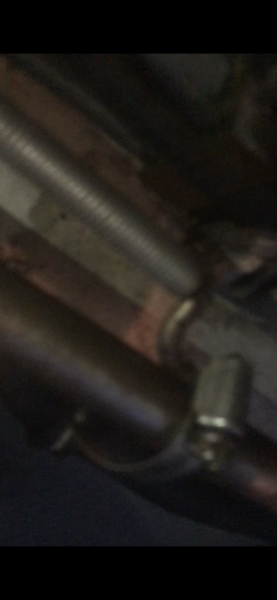

I found a video on my phone where I filmed that L bracket that you referred to while I was working on my power steering. Since the spring is in good shape and the hose clamp is still there, I’m assuming that this L bracket came out from the hose clamp and shot somewhere in the area. I took a quick look and I didn’t see it. Anyone know what it’s called or where to get it? It has a notch in it so the spring doesn’t slide off.

tcollins2, attached are a couple pictures I took last year. They may help you fabricate something if Beacon doesn't have the part available. It looks like it is just a 3" long piece of stainless round stock, cranked tight in a vise, bent to a 90* with an indent added to keep the spring on. If mine was deep-sixed, I'd cut the head off of a stainless bolt, bend and flatten the cut end, and use an acorn nut to retain the spring.

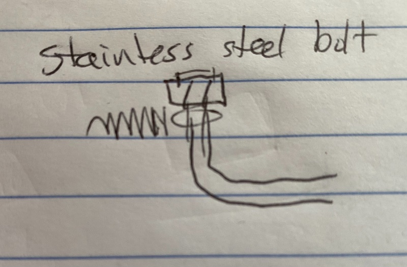

Thank you for the detailed photos. I assumed I would not find it so I started sketching a replacement before you commented. Funny stuff.
