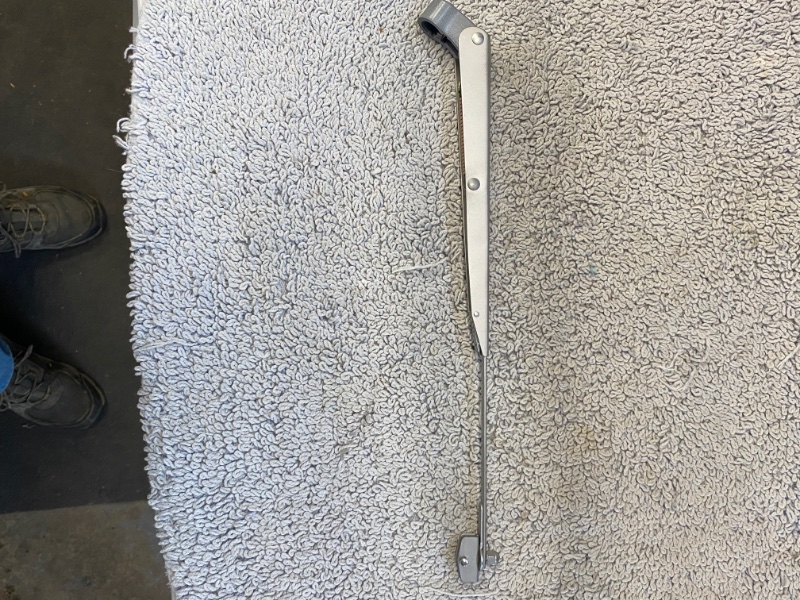

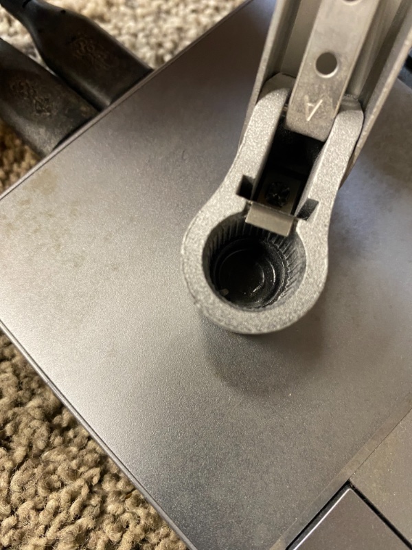

romanz829
Posts: 7
Joined: Fri Oct 15, 2021 1:43 pm
Re: f 26 windshield wiper installation
Post by romanz829 »
HI, Looked at the wiper arm where it attaches to the motor. There is no screw there or a hole to place one. Not sure how it attaches to the motor. Don't want to order a new one until I know how it attaches.
There are also pressed fit arms, ones with a spring loaded clip, and ones with a bolt on the side that clamps the arm to the shaft. What's the condition of the motor shaft? Are the splines still intact? If it's worn or corroded, a press on arm won't stay on.

Here's what the wiper and motor attachment look like. I've attached a couple of pics. Thanks for the responses.
