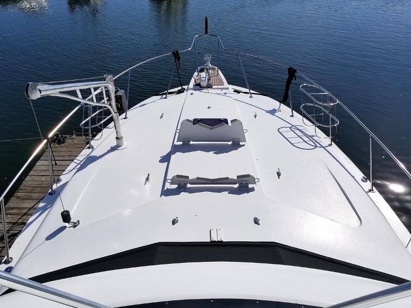

I am looking for some input, our 1989 Trojan 12M Convertible came with a Bow Davit but no information about it.

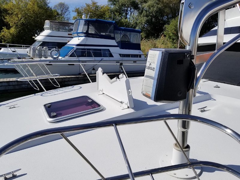

Maybe some on the forum has a similar setup and could shine some light on the lifting capacity. The Standpipe is 4"OD,
3.5"ID and 65" long.
The unit works well but I do not want to overload it. The new 11 ft Tender I am looking at comes in at just shy of 400 lbs.
Thanks in advance.

No direct experience with this unit, but I can't believe that 400 lb would be an issue. That is not very much as far as lifting goes, and what would be the point of having a crane that only lifts as much as you can? From the pics, it looks like hook height over the rail may be an issue.

I assume the support tube goes well down into the boat and is well secured. If so you will have no issue with 200, and likely a lot more.
